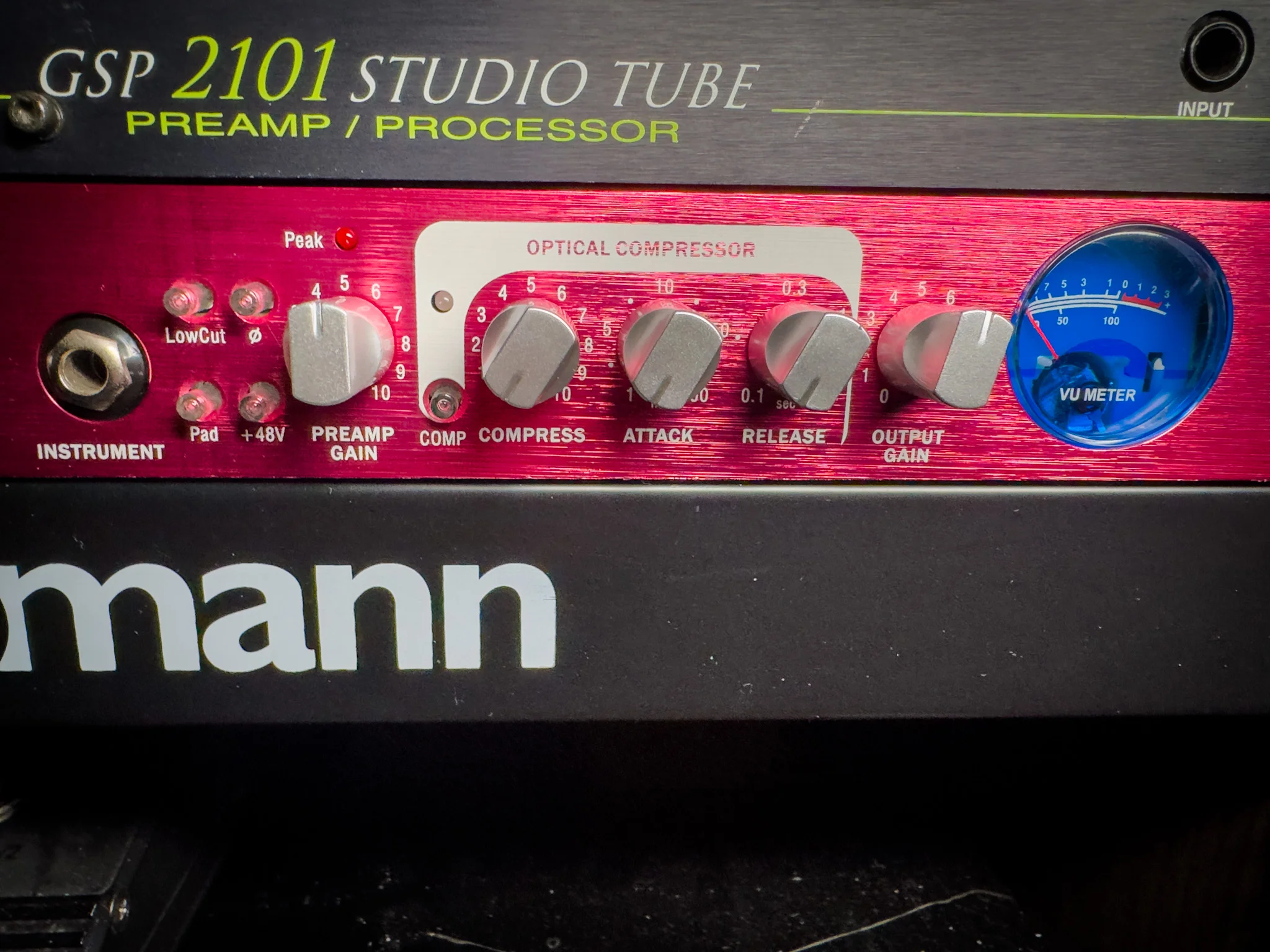

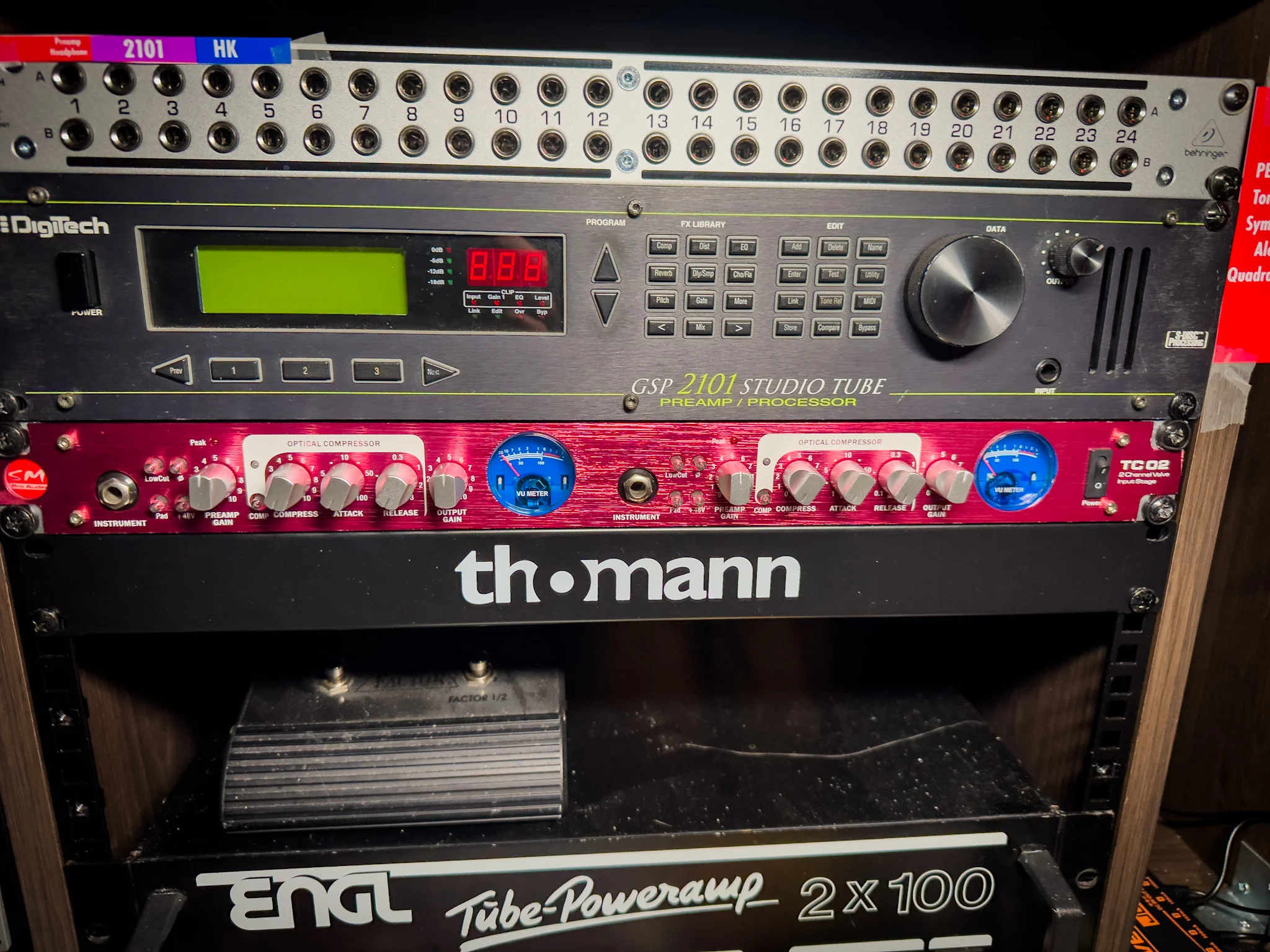

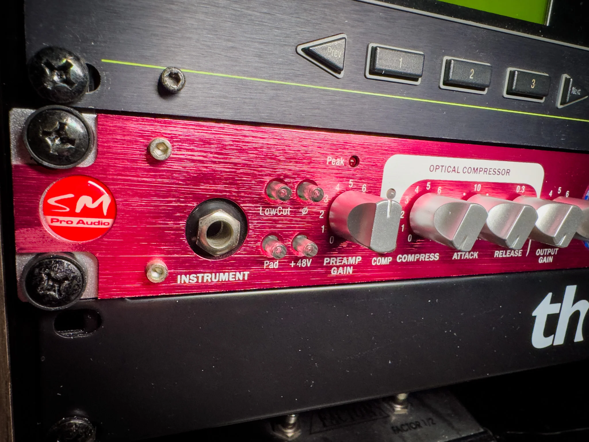

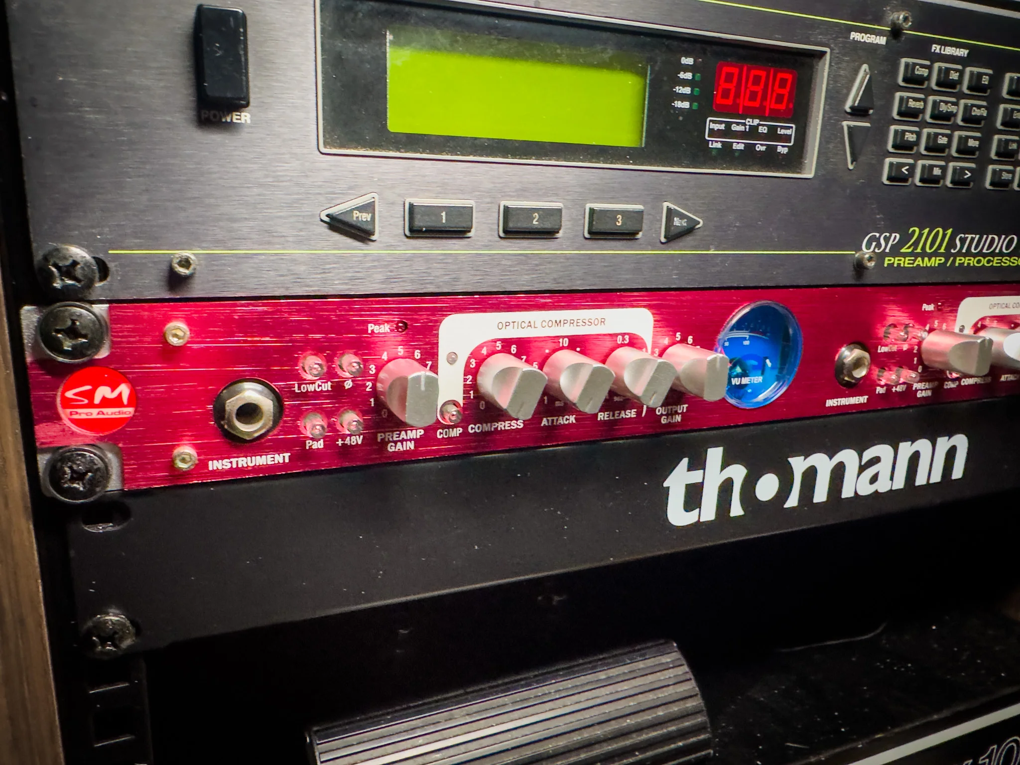

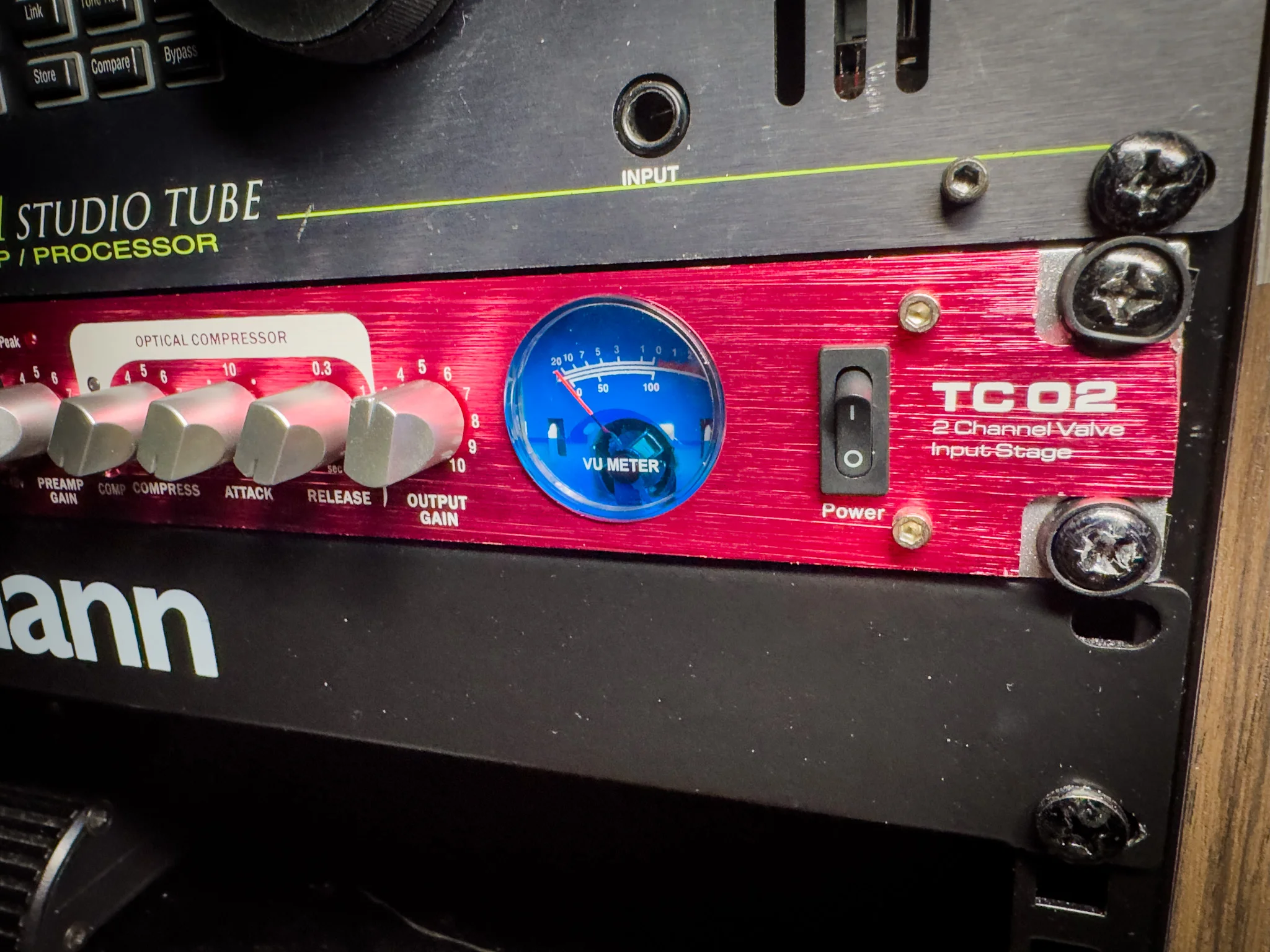

I was looking for a tube preamp to "color" and "tame" the Final mix or drum bus.
Original I wanted to buy a more hifi aimed pre amp till I found this one pretty cheap.
Testing soon :)
Maybe experiment with different tubes.
Always fun.

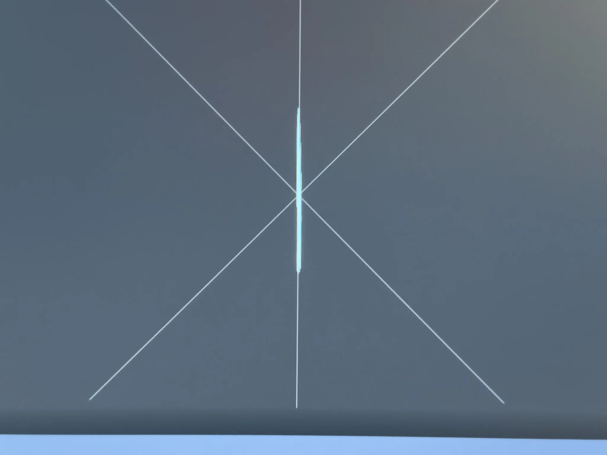

Did some measurements.
It's not a high end pre amp but to my surprise it does have a nice effect on the masterbus. It's not a 100% improvement but it does shave off some of the "pain" frequencies and glues it together

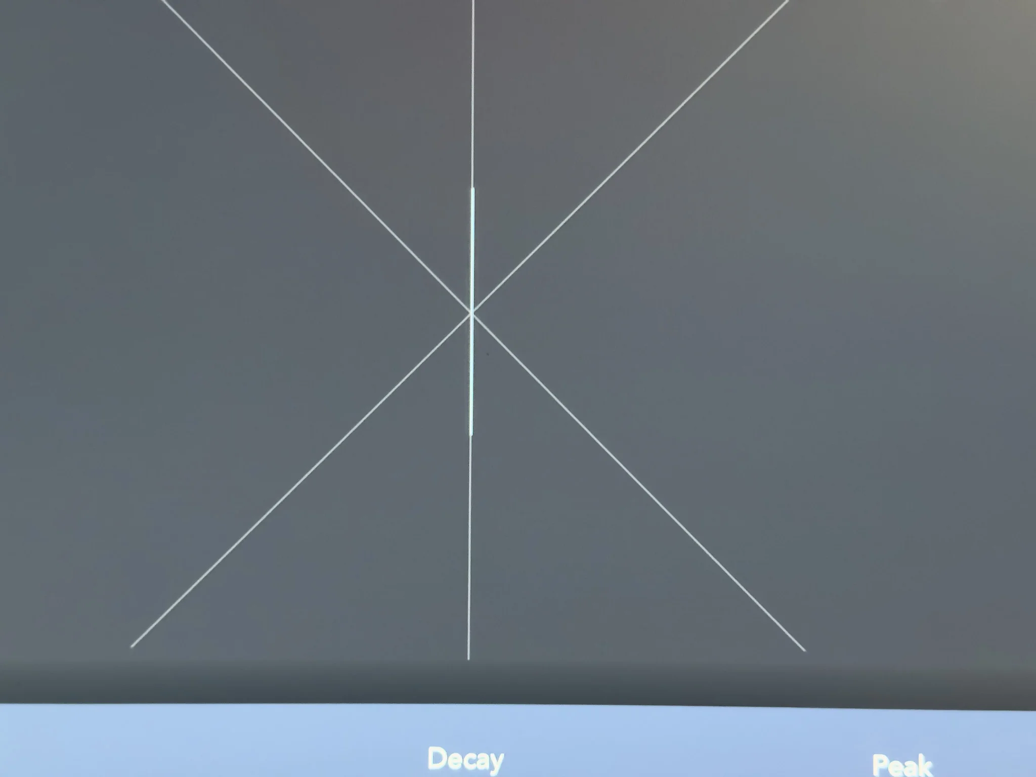

So i wanted to see what it does.
First is without
And second one is with
Interesting enough even with the compressor off the pre amp has some positive very slight compression. Which i did not expect from a tube amp that doesn't run at full power.
Input was set just below clipping with white noise.
I'm not sure what I'm looking at. 😆 Is that sort of a two axis waveform scatterplot, amplitude vertical and stereo spread horizontal, with a mono signal? If so that's also doing a SLIGHT amount of stereo widening, it seems.
I haven't tried, but I've been curious to try this with my BAEs. I assume take a line level output and then feed it into a DI level input?
Stereo signal.
Because i can't link the channels i have to balance the two sides.
In logic you can send white noise to a channel
Make sure the IO is after the noise. But before the meter tool. In the meter tool you can select the way you want to meter.
Without the pre amp it should be a straight line.
When your signal is not balanced the line will be skewed so you can balance your left and right very fast and super accurate this way. But also see what a compressor does.
Im still learning the meter tool so if I'm wrong feel free to correct me.
So this preamp is changing frequency response (not sure what the pain frequencies are), compressing the signal and if I am reading the signal right, somewhat smearing the signal.

In the images what you have is a signal that has width. In most cases this is where there are phases difference between the channels. If you feed pink noise, more audio appropriate than white noise into the system, what you are seeing is usually distortion that is different in the two channels. If you use a tone sweep, then differences might be more visible as you watch the trace move. With a noise source the distortion products changing give the width change. To my way of reading it, you’re seeing distortion but hearing it as an improvement. That’s personal choice. Historically, we had studio thinking, and hi fi thinking. One was on a quest for eternal truth, one was all about making things sound better. Then the two sort of flipped, and now appear to have gone back again. One lot spending a fortune removing distortion with one born ever minute products and the other seeking to reintroduce it with legacy products. What a strange world.

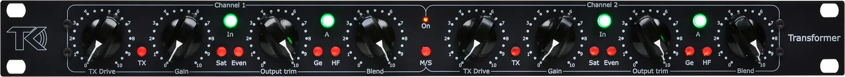

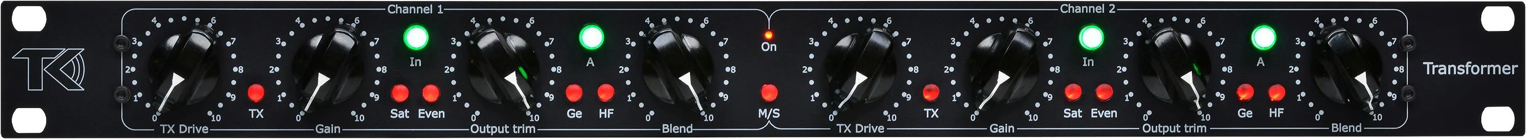

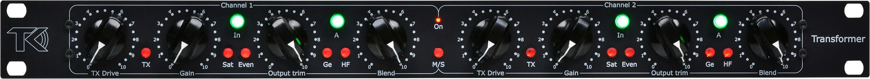

I have found advice on YouTube saying shove your mix buss through a pre-amp with in/out transformers.
I went for the TK Transformer:
Saw a video from white sea studio doing a similar test.
