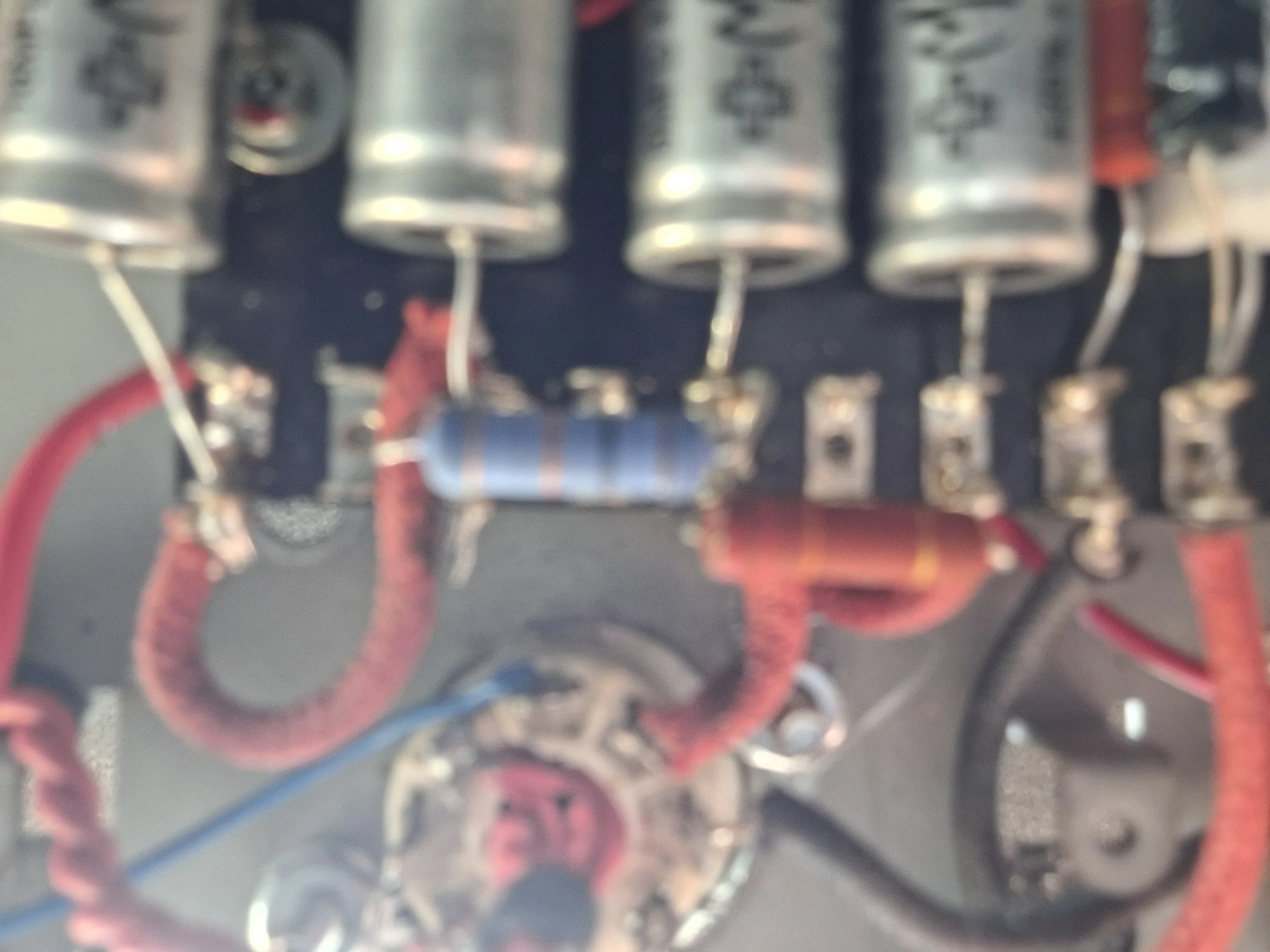

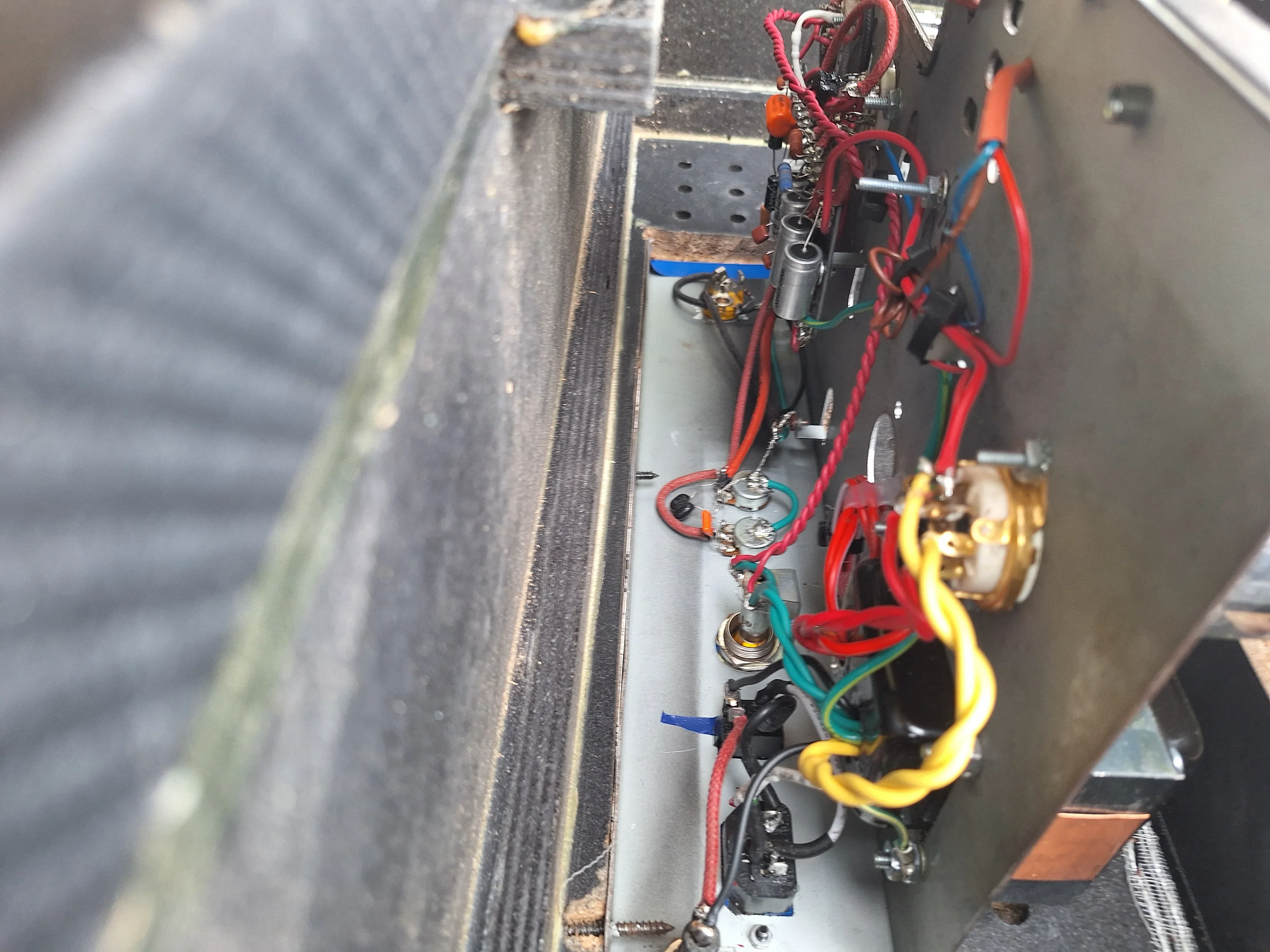

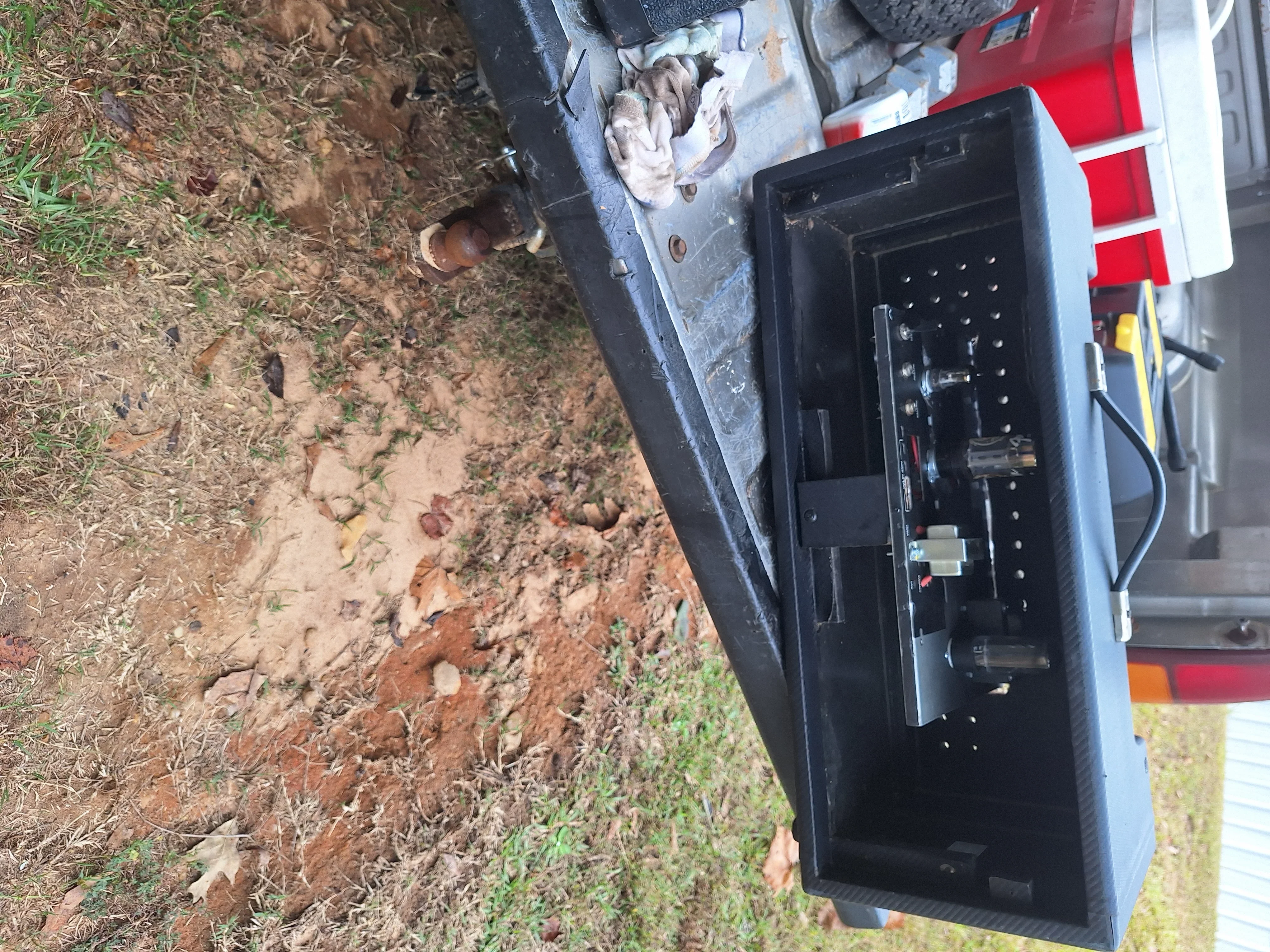

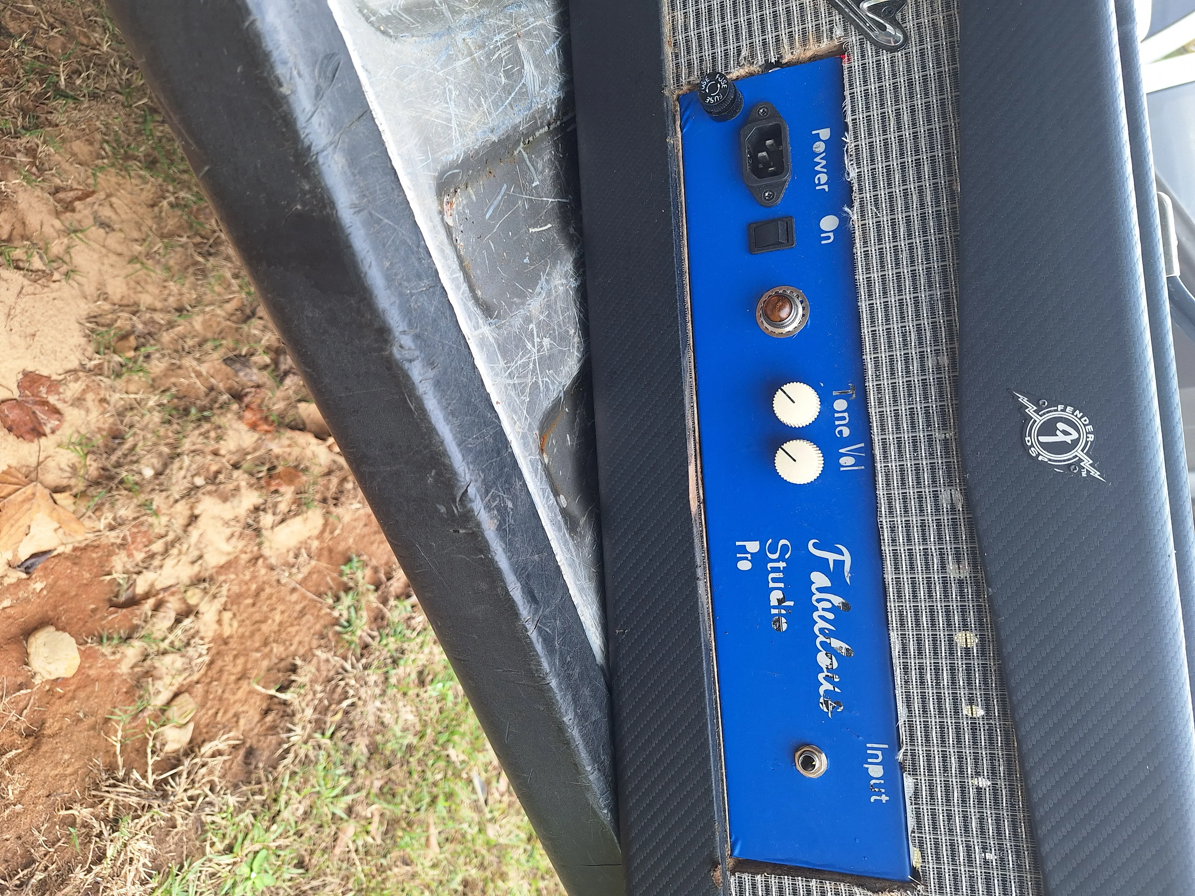

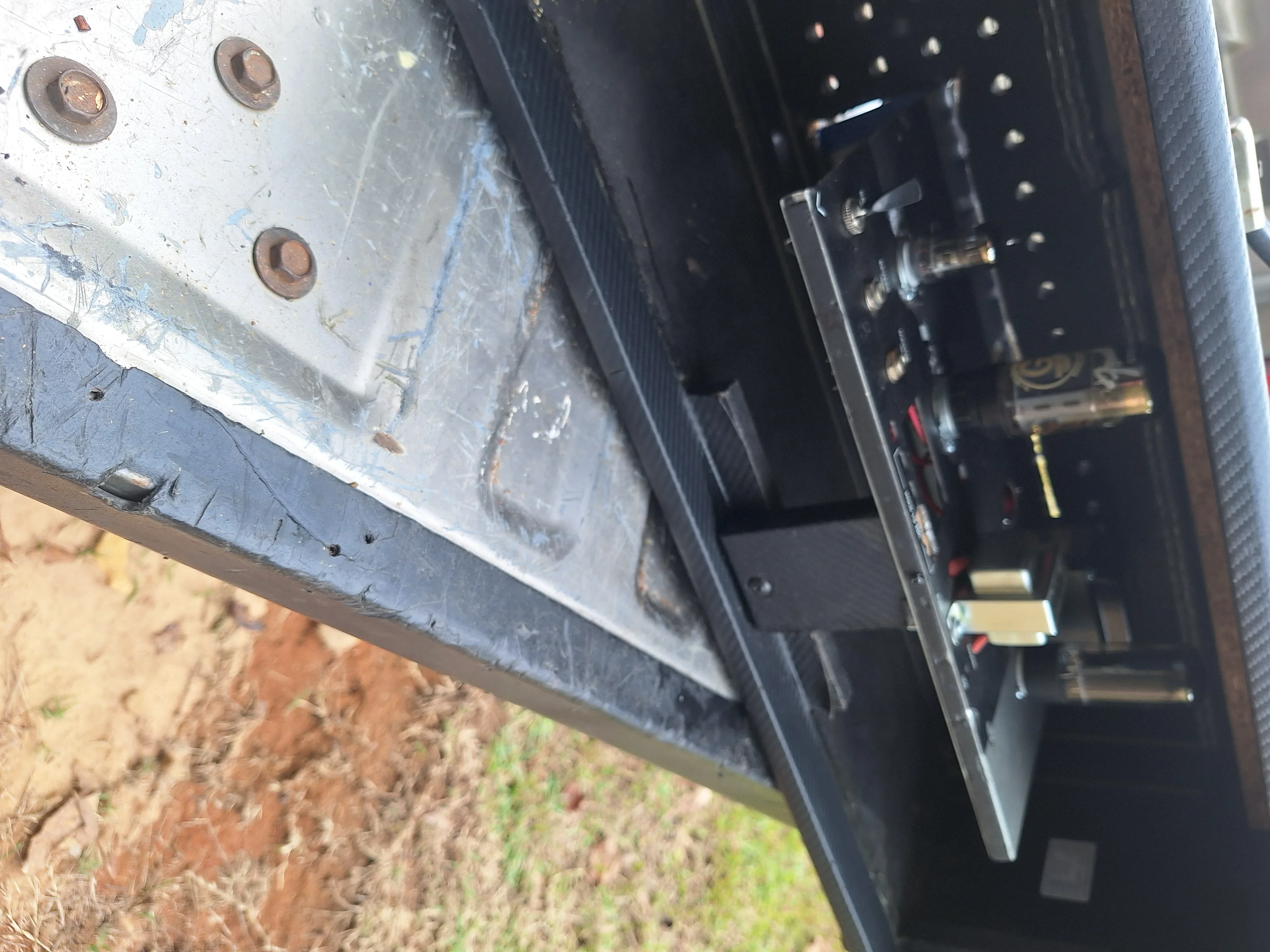

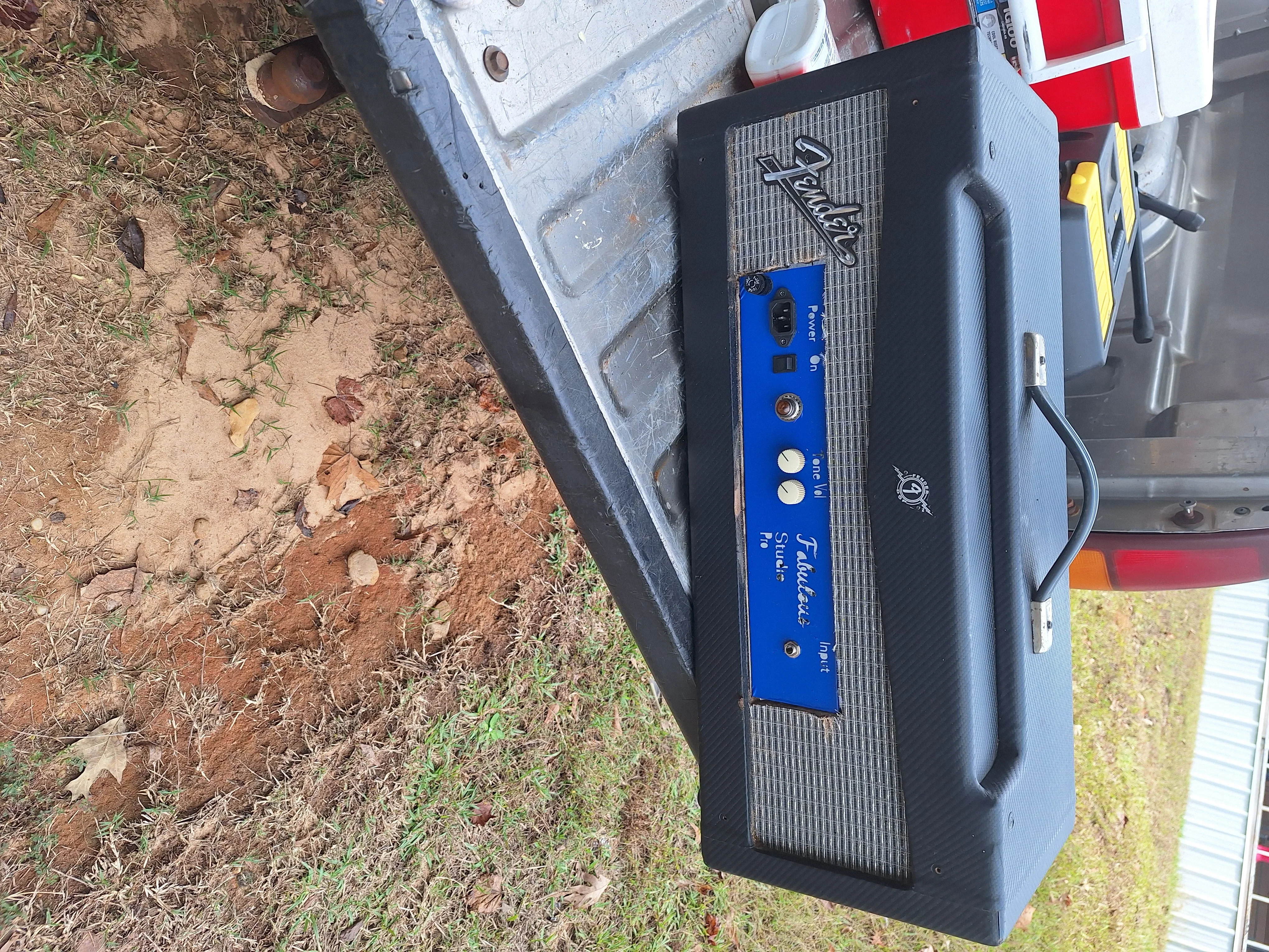

Here's some pics. Im going to trim around the cutout...maybe I dunno. Its going to sit on my 4/12 slant cab thats loaded with celestions. Thats a 4 ohm load. Amp should scream though that cab.
Its switchable from 4 ohm (the master 1/4 " is the 4 ohm input and the reverb is the 8 ohm). Im gonna have to ask him what the toggle switch on the bass input is. May be a ground switch or a stand by. All point to point hand wired!

I found out what the toggle switch is for. It turns the negative feedback on and off.
