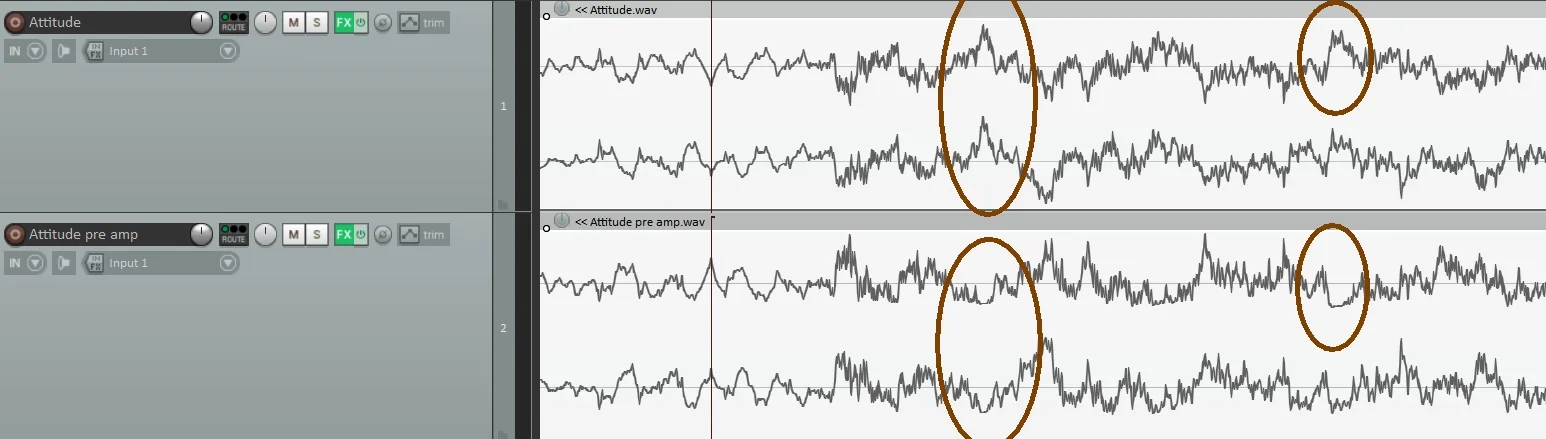

I had downloaded it last night, but didn't have anything but my laptop to listen on, so I didn't bother with trying to do any critical listening.
This morning, I'm on my other computer and have speakers and headphones. There's a bit of difference, it sounds a bit louder in spots. Not a huge difference. Maybe raspy sounding, although the guitar has already got a lot of drive. When I do comparisons I like to throw them in Reaper, so I can switch seamlessly between them. Well, I missed the CTRL button on one switch which engaged both tracks and WHOA!!! The sound dropped a bunch, and it sounded distorted in spots. So I flipped the phase button on one channel, and BAM!!! It got really loud!
Turns out your box is inverting the phase. I zoomed in to confirm and while I was looking at it, I noticed that there were a couple of spots where it seems the preamp is chopping off wave forms. I can't tell for sure, but it might even be making things a bit offset. Maybe it's the geek in me, it makes me wonder what the heck is going on. Here are the two spots I first noticed. I didn't go deeper and see if there was a pattern. But I'm guessing that those types of changes would be audible. Whether it would be an improvement is subjective.
In any case, it's doing something!
Interesting
Anyone knows why that happens ?
It's indeed a bit more "rough" personally i like it more.

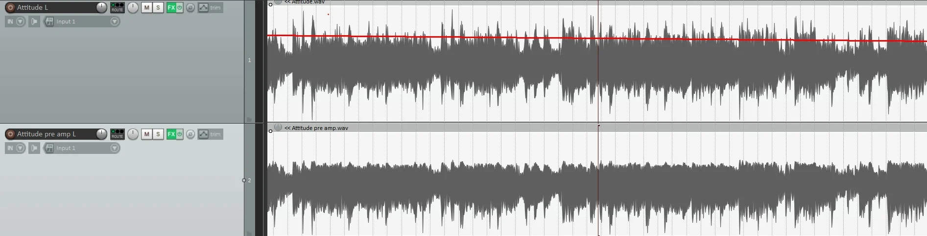

I don't know what's in the circuit, but I split the tracks into L and R, and inverted the polarity of the Preamp modified, and its definitely asymmetrical clipping. That's a fundamental difference between a TubeScreamer vs the SD1. TS is sysmetrical, SD is asymmetrical. You can see the clipping point when you compare the same channel. Perhaps Dave can comment on if this is due to diode clipping vs tube clipping.
