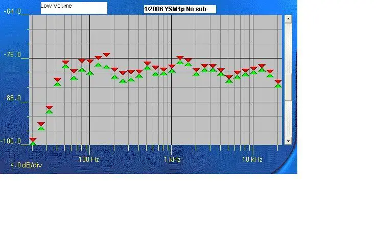

Just out of curiosity, what is the RTA room/pink noise test? Thanks.
in simple terms, the RTA I downloaded is a software package. I'm a newbie on this but maybe it'll help.
OUTPUT: It plays Pink Noise. thru your soundcard thru your monitor system. Sounds like Tape Hiss. sshshhshhhshshshss. Its like all the frequencys at once.
INPUT: You have a measurement microphone that reads the Pink Noise coming from your monitors. Mic is plugged into your soundcard, input into the pc. Mic's usually placed where your head would be during mixing for at least basic tests.
RESULTS: The software then graphs the input.
pink noise is 20-20K (which is all freqs at once). Your graph will show drops and peaks.
It graphs in Real Time which means if you turn up the treble the graph will respond in real time, high freq peaks immediately. If you decrease the High freq the chart will show a dip in that range.
here's an example, i just did.
Ideally you get a flat line from 20hz to 20Khz.
Pro's often tout +/- 2db variation from a center/average in a anechoic chamber (perfect situation).
I'm lucky getting +/-4db swing for the most part and if you notice the lower freqs really drop off. Which is common with a bedroom studio, from my understanding.

Ah, ok. I just had never heard it under the "official" name. I was wondering if there was a different test than that one, but it was the same one! Thanks!

Where did you get this software?
Allen Heath. It was free for 14 days. Then for $10 they give the code.
