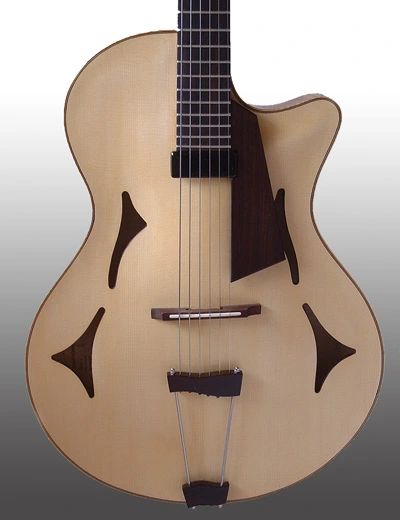

I reality there isn't too much special about that headstock, after 30 years you do get an eye for detail and good lines. To me thats what that design has. It was a combination of the guys original idea and me putting it on paper and then making the thing. The body it sits on was inspired by the lines you see on a shark, hence the fin like shape to the headstock. He or I didn't want to go too crazy on the amount of "shark" type stuff, just hint at it. This one was fun to build. As a last taster here's a pic of the body. After that I'm going back to be the usual annoying little know it all that I can be round here..:D
Nice proportions on that. The f-holes are a bit bigger than tradition, overall, aren't they? The look nice.

That kind of depends on what F holes you take as an example. The traditional older style Gibson et al, yes. In recent years the trend has been to use larger more open f holes. I think it kind of started with D'aquisto but we are all doing it now. From a voicing point of view I find to a point, the wider and further apart the more the sound opens up. At a certain point it just goes muddy. This has the added issue of being two part holes. That is a general observation though, as you know we can only point in the right direction the rest is down to, well the rest really.:)
When doing something like that one I used parallel bracing to compensate for any muddy sound and left the top quite thick in the centre to help the balance. It came out great. It was a very nice piece of German spruce as well so it should get warmer. Acoustically it holds it's own. I'm going to be building another one based on the same sort of design for him soon.

Hey, that makes sense to me... I won't ask you to give up your privacy to settle some idle curiosity, since the way the dollar's tanking right now, I'm not about to pony up for an imported custom axe any time soon. :/
That said, that body is a worthy mate for that headstock. Goddamn, dude, you have an eye for lines... :eek:
