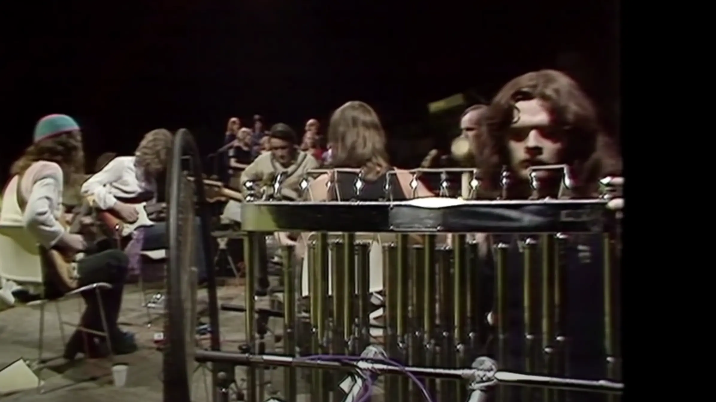

I note Mike Oldfield gave up on them, despite having an orchestra for his Tubular Bells tour - they were played from a keyboard!
I found a BBC recording from 1973 which is pretty horrible - the screen shot is two vocal stye cardioids taped to a boom arm!! Clearly the BBV didn't waste time and money on this one. The whole video is here - but it's pretty dire.
