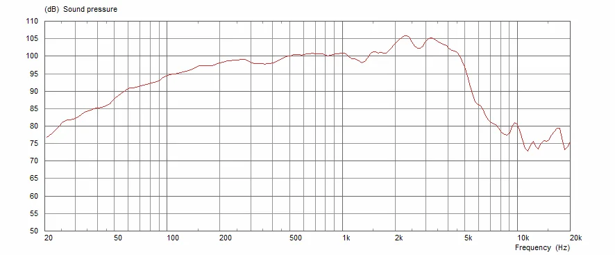

"Miccing a guitar amp is best" Arguable but there is one big omission in that statement. THE most important thing is the speaker. Guitar speaker response is characterized (as much as the very large number of them can be) by a lack of bass below about 100Hz, a peak somewhere around 3-5kHz, maybe more than one, and a response that dives off a cliff from 10kHz, often as early as 8kHz (will find a graph)
Someone, maybe two decades ago realized that this was why guitar sounded shit straight through studio monitors (or indeed headphones) Some studio tech, somewhere then developed "speaker EMULATION" circuitry! I have posted a question elsewhere to try to find this out.
The bottom line is, E guitars do not sound good DI'ed through most interfaces because they lack such emulation. Rock gods in studios might well have DI'ed their masterpieces but they then had an engineer to EQ the ***k out of it!
This lacks some context. The frequency range of an electric guitar is between ~80Hz (low E) to ~1.5kHz (high E, 24th fret). The human ear, nominally, can detect a change in "loudness", i.e. SPL, of 3dB. A 10dB change in SPL is nominally detected as "twice as loud".
From your graph, the dB change from 80Hz to 1.5kHz is ~8dB at best. Assuming a realistic frequency response to be <~ 1.2kHz, the delta is much less. According to the graph, ~ 4dB. I submit that's barely perceptible. Of course, this doesn't take into account frequency that is humanly perceptible. As we age, we lose our ability to hear higher frequencies, yet we respond more to mid-frequencies to upper lows.

I am not quite sure of the point you are trying to make friend? Regarding the frequency response of the guitar there are harmonics extending well out to 12kHz (and the MP3 encoder has surely mashed more!)
That of course was a steel strung acoustic but an electric will have much the same spectrum. The real horror however is when we distort the signal because then 3kHz becomes 6kHz and 9khz and the amount of HF energy increases. My point was that this extra "fizz" does not sound good but is largely removed by the speaker.
Also, if you look at the overall shape of that V30 response (chosen at random BTW) it is really that of a very low Q band pass filter, i.e. it will add a "colour" to the sound. Any other guitar speaker will have its own, unique 'shape'. No wonder there is so much argument as to the best unit!
