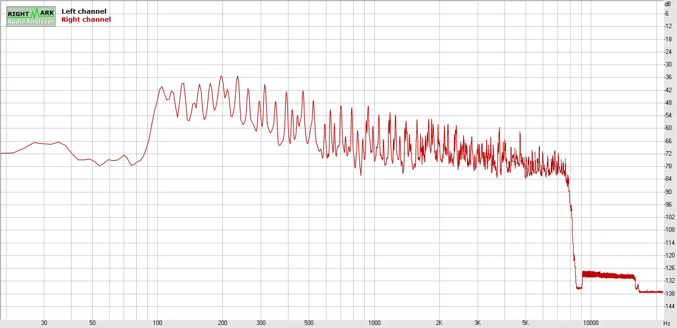

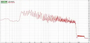

Looks like you have a HPF on the track. I have nothing showing below 100hz. A recorded track of acoustic should have that.
Yes, guitar does go own to 80 Hz and there should be some "chunk" below even that. Of more concern* is the cliff edge at 8kHz. That could be the result of the MP3 smash (I like an attachment of the best 320k MP3 you can do) but if in the original you have lost all the "air".
But, I actually agree with Jim, not really a lot wrong with the basic sound. 16 bits should not really add too much noise, CD noise floor anyway, but many cheap 16 bit converters need Windows setting up properly for them. You need to make sure to have the record gain very low.

Regarding the frequencies in the recording, the guitar's low E string stops at 82Hz (E2) so maybe over-agressive HPF; but beyond that, this sounds like a guitar with a capo on the 3rd fret (playing Am-C "open" chords), so I'd not expect much low frequency now that it's stopped around 98Hz (G2)!
