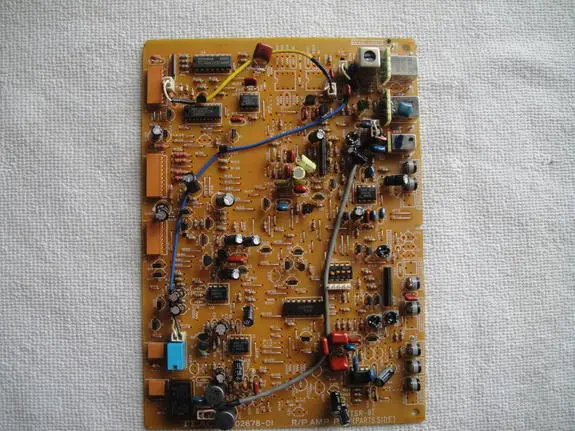

Here's a picture of a Tascam TSR8 channel card attached.
Bottom right on it's side is a axial electrolytic cap, probably around 35V -63V (Voltage) with the value in uF also written on the side, replace with the same voltage value or higher, there's probably around 20 on this PCB board & some extra yellow types.. The back of the board will have a + sign for the positive pin beside the solder holes for that part. The cap will usually have a strip down the side for polarity. +/-
The red & blue caps are normal polyester, mylar or similar caps, it doesn't matter which way these are inserted just replace with same or higher voltage value. There will be cap codes on these to denote cap value ie 104 Just do a search for a cap code chart to find out the exact values. Also watch out for those mustard / yellow caps around the same size, they might well be Tantalum caps which like electrolytics would to be installed with the proper polarity !!!
The resistors, mostly cream coloured on this PCB have stripes across to denote ohms value & resistance, usually they are 1/4 or 1/2 watt with an odd 1 or 2 watts, check all these with a magnifing glass to see if they are breaking apart or expanding, these look like carbon films & a couple of these types were faulty on my TSRS causing crackling on one channel board. Look for a resistor value chart or there are java programs for your computer to download & install.
Most of the rest including opamps, relays, transistors, pots, connectors & inductors won't need replacing unless faulty.

Are the E16 audio cards really made by TEAC...?
EDIT: That looks a heck of a lot like a TSR-8 card, actually.
Lol! It was late at night, anyway the Fostex has yellow cards as well, must have the photos mixed up!!!
