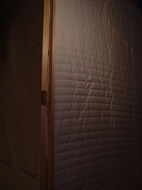

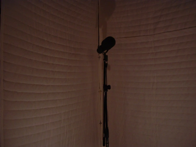

I purchased some of that stuff and some wood and made this thing.
it's two walls connected by three hinges... when I put on the ceiling and backing it's not sound proof at all but it's pretty damn dry. It cost about 170 total for the blankets and the wood/hinges/reinforcements etc. and is totally portable. I also have 6 extra blankets to hang up wherever I need. I'll be purchasing two bass traps in the next couple of weeks.

Looks like it should take out some of the drywall sound, at the least.
hell..anythings better than the drywall of sound. :eek:
looks like you're working more on the "tracking" aspect of things.
if its an improvement, thumbs up.

Let me expand on that thing I made. First of all... i've never had any experience with tools so that's not an excuse. I just bought a $20 power screwdriver and a $5 saw and started working and those are both tools I'll use again and again. Those acoustic blankets have an NRC of .70 which is pretty decent AND are completely hangable and movable. But moreso... I only used 2 out of the 8 (they are about 6.5' by 4' each for a total of 196 square feet)) which cost $130. That's about $16.25 X 2 (not including shipping) for blankets actually used permanently on the walls. Plus about $20 in wood, $8 in reinforcements and $8 in hinges and screws that comes to about $68.50 for something that is most likely at least as dry (absorbant) as that and much more versatile (an 8' by 6.5' hinged and foldable wall which can be moved and placed anywhere). And here's why it's versatile...
You want to track vocals? set it up to make a triangle, put the boom in the corner, and pull a blanket tightly on top (clip it) and across the back (clip it). In effect, there are absolutely no reflections, and if you need to absorb some bass, you have a corner directly in front of the singer for a bass trap.
But you want to track acoustic guitars? Open it up to a large triangle, or even full 8' (more like 7.5') wall and have the guitarist play towards it... it will be less absorbed, but it will deaden any ring in the room and you could set it up to remove parallel walls and standing waves.
so you're mixing ... with the same bass trap in the corner, set the thing up behind you, as far back as you hear an improvement.
It also serves as a nice way to hide from your wife if you're poor enough to be living in a one room apartment with her.
It's not sound proof but nothing you buy will be unless it is completely air proof as well... and how are you going to breath in those conditions without an air circulation system?
Like you said, most cheap things likely have their flaws, I'm not hip to the specifications of a tracking room and especially a mixing room... but it costs about $70 to make (minus the tools and extra blankets which can be used again and again in other places) and can always be put away if it's hindering anything. And from using it a few times on vocals... it really really helps.
Going to Lowes and buying doors to hinge together and then hanging blankets on them would be more effective than what those folks are selling. It ain't gonna be sound "proof" (nothing in the freakin' world IS but you won't even get real close) but it may be worth something.
