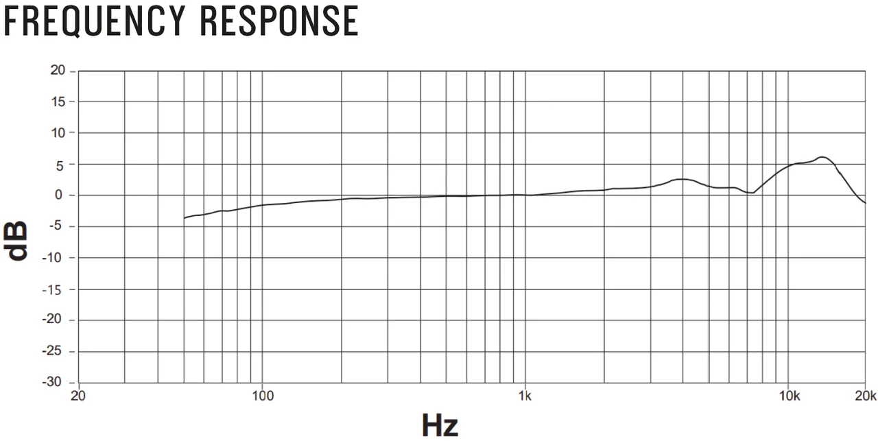

Wondered how you faired with the Shure SM4- it has a dramatic rise after 8k and a small bump about 4.5K -
not a particularly different sounding mic than many others.
SM4
its a lower sensitive mic -12mv/pa / -38dBV. that can be a good thing in the untreated room.
Cardiod only covers most work. Id spring for the shock mount, case
.A Rode NT might be a competitor , AKG P series same price range , $300 bucks there's a lot to choose from if you include Used.
