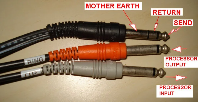

Thanks for the reply Otto. I'm thinking about going out now to get some cable. The thing is, I realized that when you "insert" to a mixer channel , where there is just one 1/4" TRS, you are actually going in and out of the equipment unbalanced, because that's the way those TRS insert cables are made. Which made me wonder is it really necessary with short runs.

This is not to hook up gear with different impedance, it's all +4, because the mixer has unbalanced inserts I was wondering if it was completely necessary to use TRS cables with other TRS +4 gear. The mixer has the single send and return 1/4" TRS, but it is a +4 insert. :confused: Are you familiar with those?

TRS inserts are unbalanced as you have noted, so get or make the TRS to two TS 'Y' cables and you're good to go. If you have issues with noise (which you shouldn't if your cable runs are short, like less than 25', and if you're careful to not run the cables parallel with power cables) then it will be time to troubleshoot.

Soundcraft mixer inserts one 1/4" TSR to go in and out, unbalanced. +4
US Audio Gatex + 4 balanced TSR in, and balanced TSR out +4
UREI little dipper, balanced TSR in and balanced TSR out +4
FMR RNC unbalanced, 1/4" ins and outs, 0db

Yes...always good to read the books but based on your gear list you can just use standard TRS --> (2)TS 'Y' "insert" cables. The balanced vs. unbalanced thing won't effect the nominal level, and plugging in a TS cable to the TRS jack on the outboard gear will just negate the balance amp...it will be unbalanced without you even knowing it.

Steve, there's nothing "unusual" here, +4 inserts and/or direct outs are common. That's what I'd believe your mixer's internal operating level is, that's all.
You need to forget about the whole "issue" ..heh heh ... if you are going to use those inserts with the gear you've mentioned and simply use insert cables (see attached pic). It's not an option, it's The Only option here :)
Just double check what your mixer's inserts tip/ring send/return are.

If you have time and energy, make your own custom shortest cables that fit your setup. This also may well be a waste of time ;)
