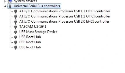

I had a odd thing happen, my USB 2.0 somehow turned into 1.1?
So when I connect my interface it says , "the device will run better on USB 2.0...."
the computer, or windows more likely, messed up this up ...I guess?
<below pic>
Device Manager it shows one hub as USB 2.0 but none of the USB ports talk to my recording interface in 2.0 anymore....always USB 1.1
any inputs appreciated....i been rebooting and erased all the windowsm and even upgraded to Windows 7 and deleted the USB hubs and they still come back 1.1.

Have you tried updating the driver from right-clicking properties on the ATI lines?
So you are running Win7 now right? Or did you go back to XP?
That is a weird one for sure. It was not uncommon for a year or two to find machines with both USB 1.1 and USB 2.0 ports, but all recently built PCs should be USB 2.0 only. And I've never heard of one "regressing" as you describe.
Unfortunately, all the solutions I can think of off the top of my head are ones you've tried already. I still think some incorrect setting in the BIOS would be the most likely cause.
arcadeko,
I am running Windows 7 now.
I did try the update drivers ATI, and I also deleted the 1.1 + reboot and the Windows found them the same

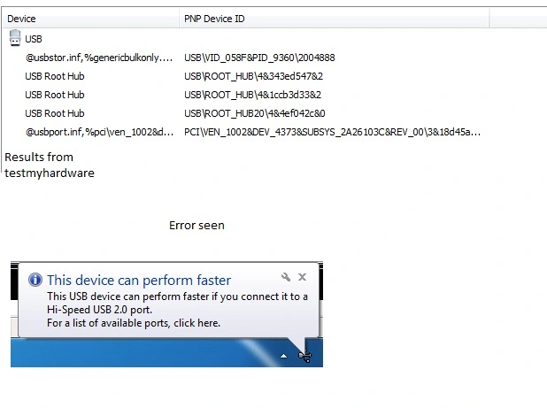

that should be a cool test, but the TAscam causes it to read out and the control panel of the TAscam interface states 1.1...
so I'm not expecting anything.
It is a on board set of USB ports....no pci. (i took the card back).....yes I tried and returned a card and the guy said it wouldnt recognize 2.0 probably because the HOst was wrong or something.

here's the results....and error pic.
