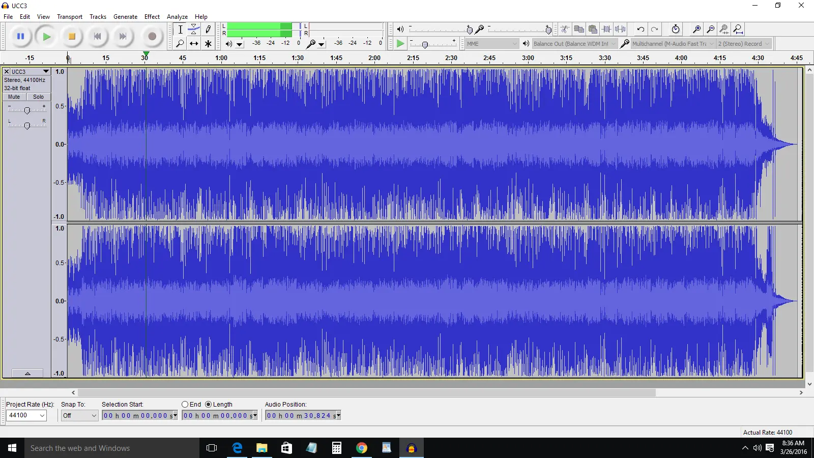

Hey Trip, what do you mean "It's probably -13 to -12 RMS"? It looks like this.
I listened again. It sounds pretty much the same to me.

This mix is just as loud as the others. Manslick: that's what it looks like in Audacity to me as well. But look at a modern mix, and you'll see a much more dense "block of blue."

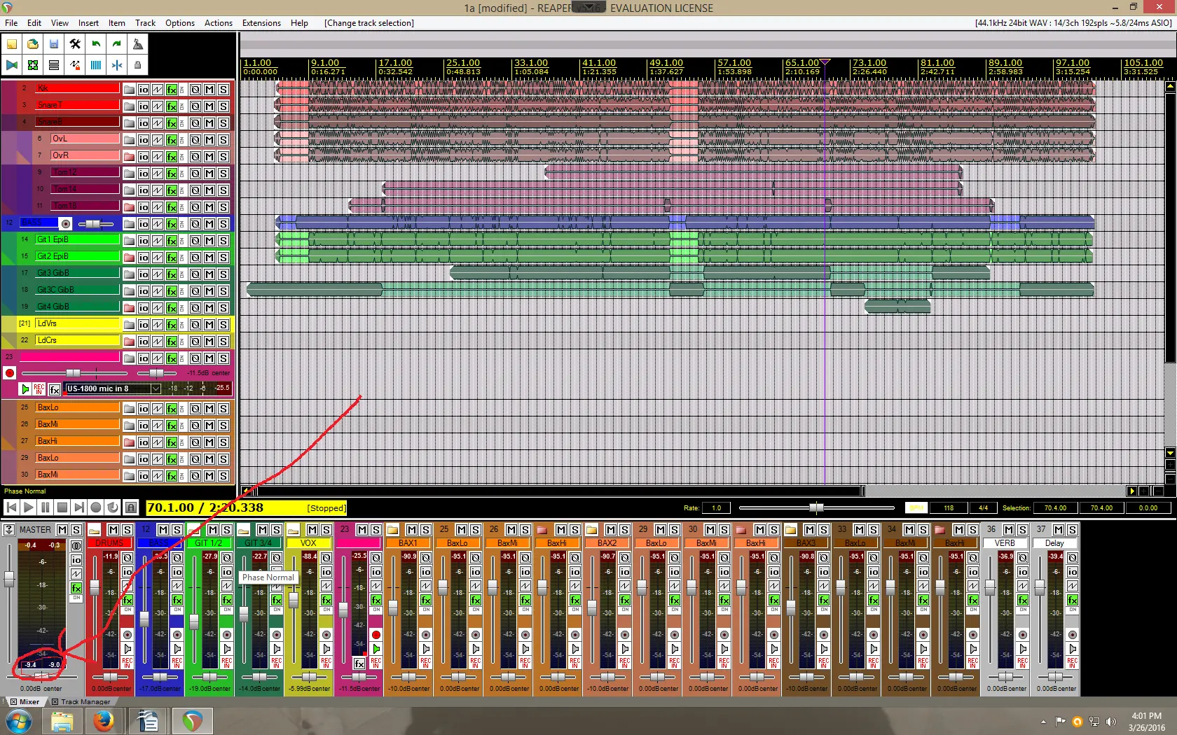

Hope this helps...Look at the bottom left:

RAMI - I saw that in Reaper on my machine after your post. My meter scale is different, because that spot you circled is showing just over +3 in the verses and about +4 in the chorus. The upper end of its scale is +12 (so I'm guessing a +3 corresponds to the -9 you were seeing). Do you know what scale I'm using and how I change it? The peak meter is dbFS - it peaks at 0 - so that makes sense. I just can't figure out the RMS meter.
That's weird. Try right clicking in that area and you should get the options I mentioned: "Peak and RMS", "Peak only", or "RMS only". I think there's also an option to put "Peak" or "RMS" on top or at the bottom.
