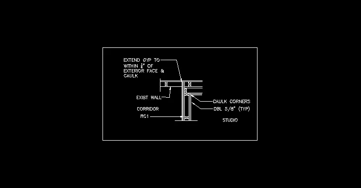

Ok - here's a detail for exterior walls - but i was also refering to that lowest left hand door - you need to get to the outside bottom of it......

I'm kinda getting lost here; do you or do you NOT have a floor plan of this project? Because I'm at a loss as to where Rod's detail should go; for one thing, I'm trying to figure out why half of that drawing isn't a triple leaf; Also, in

Rod, why is the upper right half of your last drawing NOT a triple leaf, or is there something I've missed that makes it necessary?
Steve,
From the topmost of the drawing.........
Exterior sheathing - exterior 2x4 wall framing - 1" air space - interior 2x4 wall wall framing - 2 layers of drywall.
the middle is just air - I would not put a third leaf in my friend ..........
Wall on left that turns down the page is - (left side) 2 layers of drywall - 1/2 RC1 - 2x4 wall - 2 layers of drywall - (I agree with you on the RC)
The left 2 layers are on the corridor side of the wall - (the door to the outside world) and should continue to within 1/4 - 3/8" of the exterior sheathing (fitting around the plates with the same clearences) and then should be caulked.
This will stop the short circuit that exists at that wall end.

http://www.homerecording.com/bbs/attachment.php?attachmentid=11200
"but i was also refering to that lowest left hand door - you need to get to the outside bottom of it......"

Mike,
The whole intention of my sketch above was to deal with that exterior door and the issues related to that.
I must be getting pretty old if I am having this big a problem getting my message across.......... lol
I guess I'll do a different detail that shows that outside door.........

Hey Rod; I didn't consider that the middle section on that drawing was just air, guess it's MY mindfart this time (duh...) I knew you wouldn't "do a triple", but for some reason (like 12-hr shifts, 4 hr. sleep, bad cold) I just couldn't see it -
