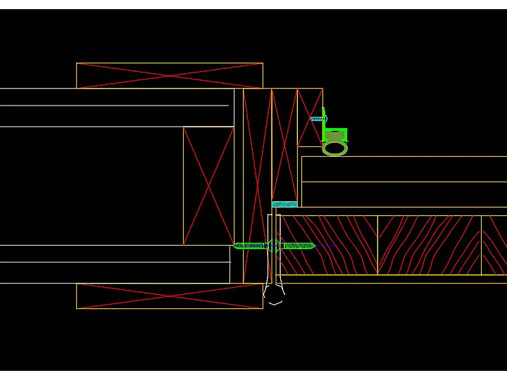

Yes at least one solid-core 1 1/2"
Just for information sake, usually solid core doors are 1 3/4"(so you don't build the jambs assuming stuff!).
As to the neoprene, I would find the 1/2" round SEALS instead Michael. In fact, the reason Rod said to offset the last sheet of ply, was to create a 90 degree path for leakage. Use weatherstripping AND seals maybe like this. Just an idea Michael. Out of time. Later.
fitZ

Well Fitz, did ya see my clarification drawing?
http://home.ucwphilly.rr.com/livesound/dooroffset2.gif
Did you see where I may have misinterpreted the 'Magnetic Latching System' for a 'rubber weatherstrip' on the face of the stop?
Ya know I'd like to go with just 2 heavy duty slide bolts on the inside of the door (nice n tight) (I'm already way over budgeted) :eek:
Can you please check for any other misinterpretations on my part in regard to your CAD drawing?
Yea, I sure did. Thats great. I would have done the same but I didn't have time. I'm on the last day of a building project myself, with a deadline. FUCK I hate deadlines. Of all things, it's a shelter for a WOLF :eek: ....hahahaha. I already built a smaller one for their Rocwieller. Geeeeezus, this thing is HUGE. Oh well, lifestyles of the rich keep people employed :rolleyes:
Well, about that drawing. You know Michael, I only try to draw ideas, NOT set them in stone. This coulld be interpreted different ways with different budgets, skills materials etc. It was only to illustrate a DOUBLE offset. After checking into designs from companys who build acoustical doors for HIGH isolation, I found that one of the biggest leaks is the path around the door. This is how THEY solve it. Double stops and seals. Which means the threshold too!! Otherwise the weak link syndrome rules. I didn't have time to detail that, but personally, I'd use a CUSTOM made solid hardwood threshold with TWO compression seals. I don't have time to draw it today, but tomorrow I will. ALSO, DON"T forget that for close tolerance doors, the LATCH EDGE MUST BE BEVELED.. 4 degrees usually works. This means the additional MDF panels will have to be beveled ALSO. Probably best to machine
the bevel on the panels PRIOR to fastening them to the door. Once the door is up, THEN size the thickness of the stops for close tolerance. I'll also draw a picture of that tomorrow. This bevel is VERY important for a tight gap. Also, the alignment and detailing of the stops/threshold seals is very important so you don't have gaps. I'll draw an alignment drawing too. But you have to let me know exactly what you are using for seals. No doubt there will be a NON flush threshold, but most front doors have some sort of threshold yo step over anyway. They do make a threshold that LIFTS the seal, and some that have a spring loaded aluminum extrusion/neoprean seal. These can be found at most hardware/home improvement stores. I even have one in the shop. I'll post a pic of it tomorrow.
I've read that the magnetic stuff isn't that good. Not only that, you have to ADD a metal strip to the door..otherwise what would it pull against. What I drew was a secondary FOAM or NEOPRENE WEATHERSTRIPPING seal. There are MANY ways to do this. I didn't have time to REALLY detail it the way I see it. That seal would be better as a HALF ROUND compression seal similar to what the other looks like. But, how much time and money do you have??? :D
Michael, one other thing. I would forget the SLIDE BOLTS. Saftey and possibly code would dictate the use of something else. I DO have a couple of ideas, but again, tomorrow.

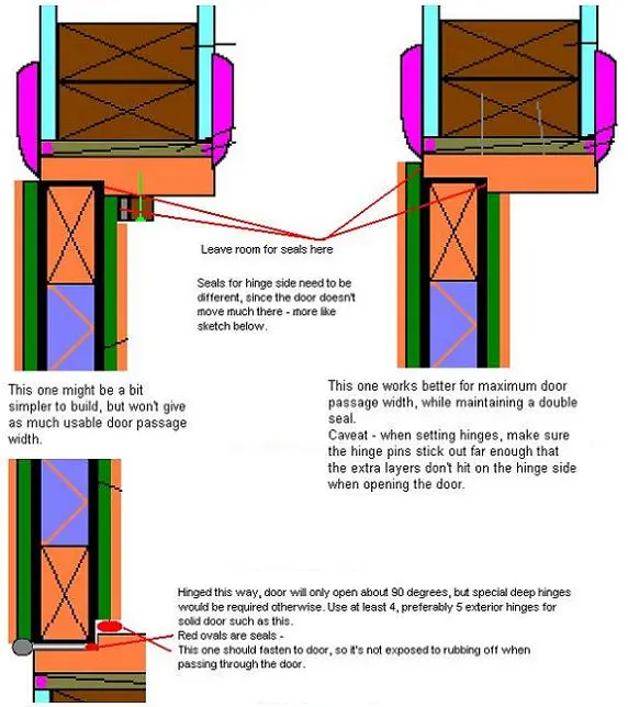

Michael, see if this is clearer - Steve
Hello Steve
Well thanx for the additional sketches. :cool:
Unless I'm missing the concept here, it still appears to me that you're illustrating that the jamb will need to be rabitted the entire length of the jamb from top to bottom? The indentation in the door jamb seems to allow for a recess that creates a stop where the edge of the door seats itself. Then there is an additional stop.
Is this right?
Guess my more simplistic construction idea doesn't cut the mustard eh? :confused:
Sorry for the confusion :o
The main stop that actually stops the door is built into standard door jamb material; where you put the SECOND stop (and seal) is the only diff. If you're planning on building your own jamb from scratch, you have more time and patience than I do :=)) Steve
And yes, I'd use double seals no matter HOW you do it. Or just put a standard hollow core door in, don't fill the shim area, and live with STC 22, and a TL of about 10 dB @ 50 hZ...
