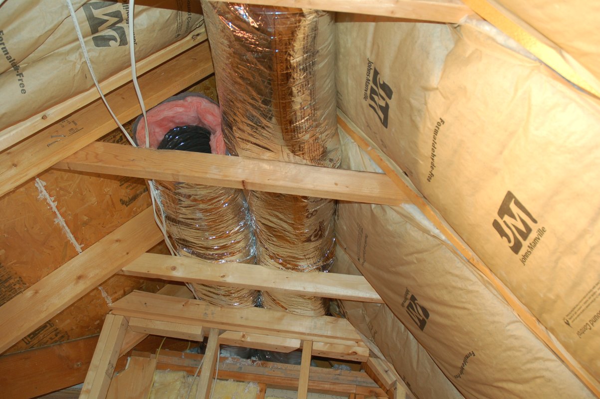

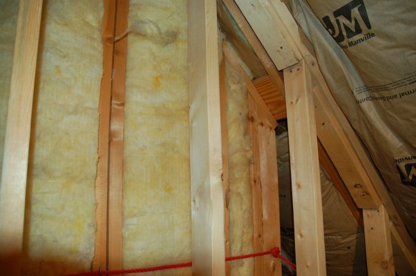

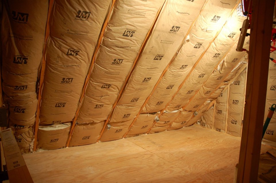

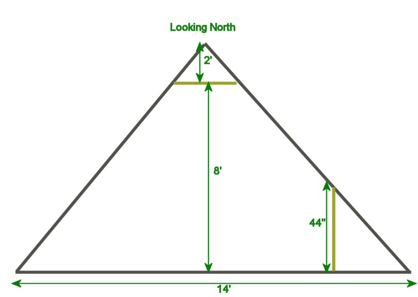

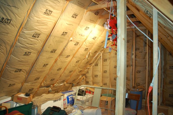

Yellow line shows insulation areas, which are along floor joists, just lay on top of your floor is fine, in between the vertical kingposts(not sure what you guys call these) then up rafters and along your new ceiling ties.
Red line shows ventilation path, you may or may not have a vented ridge, depending on whether a breathable membrane was used as tile underlay.

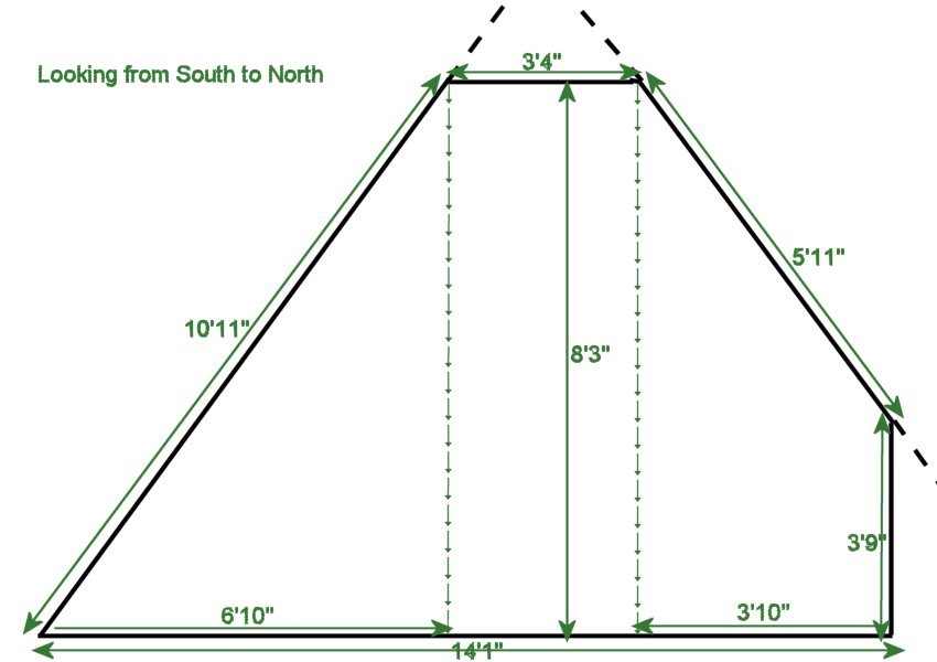

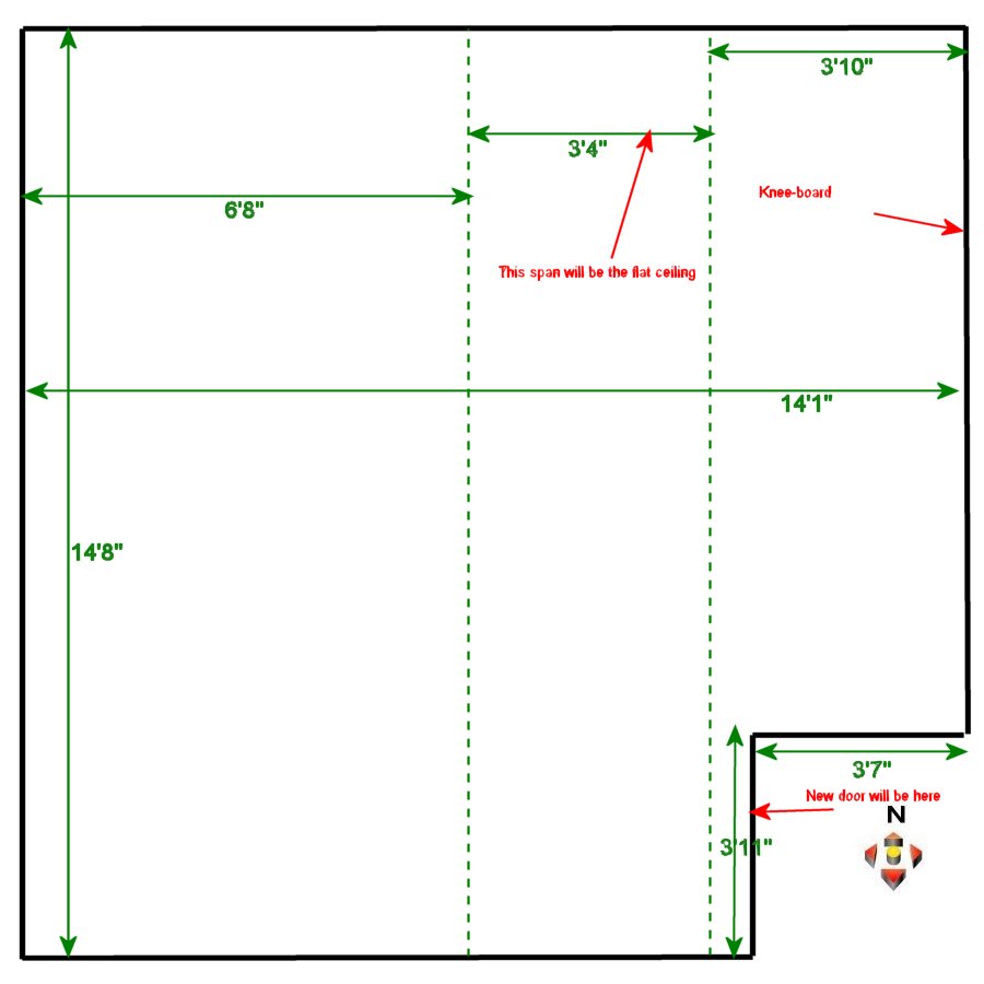

What is anybody's thoughts on knee-walling my west wall down further than the east wall.......if I knee-wall it to the east wall height I'm loosing alot of square footage.....if I knee-walled the west wall at 24" instead of 44", what would that do so far as room acoustics?

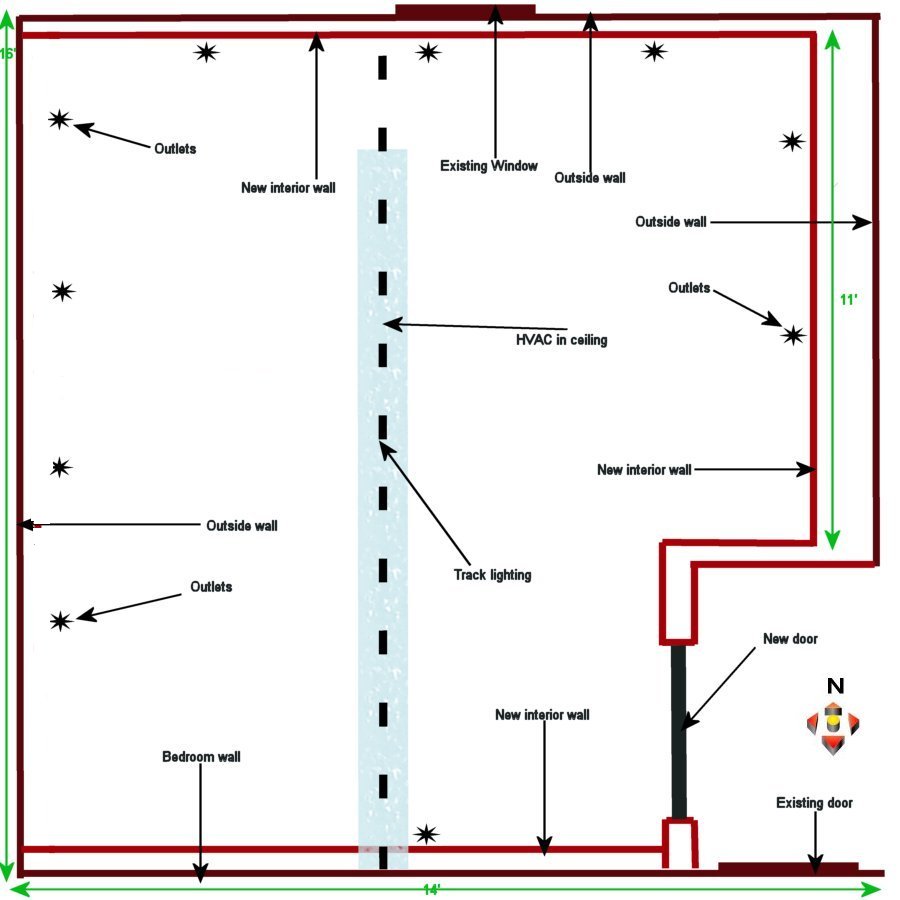

Also, I was going to redo the south wall as Rick suggested, but should the angled walls (with doors) come to a point in the middle or can there be some flat south wall.......
\/ or \_/ ?????????

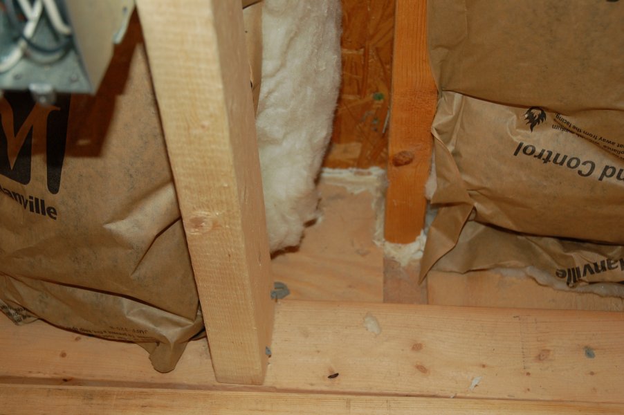

Well, I took another good long look around the studio and I think I've came to a few decisions......
1) Since I've been advised by several people now, I'm going to go with the PVC plan to ventilate the vertical rafter cavities......I can still do this now....any further and I'm stuck.

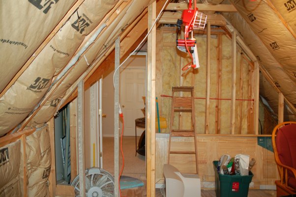

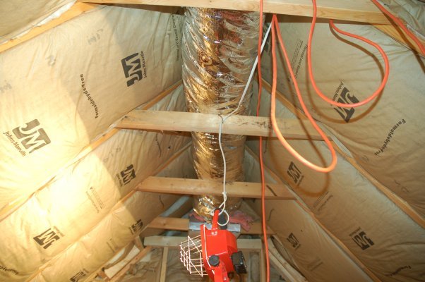

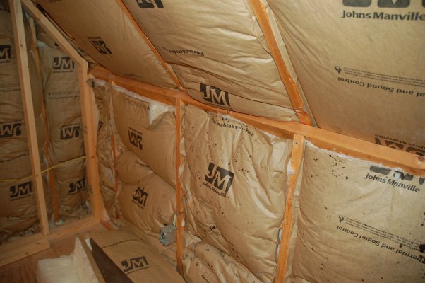

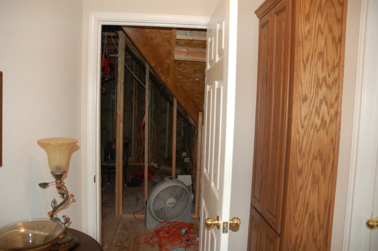

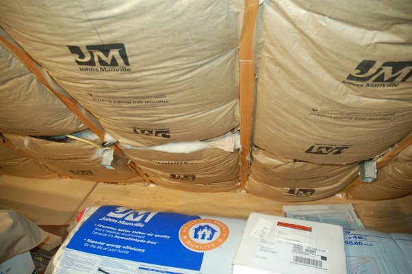

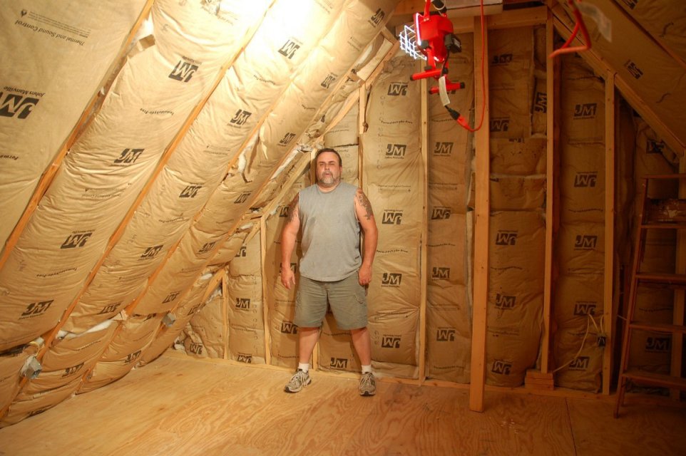

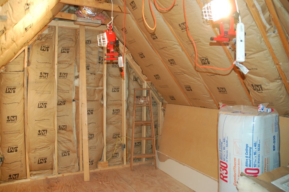

Well, after 3 years of delays (other projects, lack of finances, mixed in with a helping of laziness) I'm finally getting back to this project.....
Had to get a new permit since the old one expired.....got a building permit and mechanical (for HVAC).....have an electrician coming out early next week....the electrical has already been roughed in and hooked into the breaker box (breakers are not flipped on yet). Built a couple of baffle boxes for the HVAC....I have a send and return into the room. Room is insulated on 3 sides, haven't finished framing out the door area.....will do that early next week. After alot of contemplation regarding the floor, I decided not to float it.....this room sits over the garage so it has drywall/insulation/1" plywood. To float it, I was going to use Aurelex pucks/1" OSB/laminate flooring......after re-reading various posts and also Rod's excellent book, I think I will go with 1/2" carpet foam, then 23/32" OSB, then laminate. The walls will be 5/8" drywall, then Green Glue, then 1/2" drywall.
HVAC is done and tested. I will get the inspector out next week to approve. Hopefully I can get the electrical inspected this week also......would like to start drywall next weekend.
Anyway, I appreciate the input I had years ago.........if anyone wants to chime in, feel free. I will load some updated pics soon.

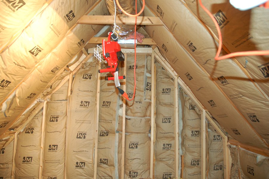

My concern with this build has always been the extra weight load.....I got a Structural Engineer out about 3 years ago and he was useless......told me to disassemble the floor and basically acted like he couldn't be bothered anyway. If I understand this properly though....the 2 layers of drywall+GG would be putting weight on the perimeter of the room which would be the top caps of the garage, which of course sits on vertical studs. The additional weight to the middle beam that runs down the middle of the garage (and therefore studio) would be impacted only by the weight of whatever I chose for the floor. Right now I'm wondering if just doing a single 5/8" drywall would be enough......I could try it and then test it out, then add another layer if I need to......here is what the leafs are, going from outside to inside and by direction:
West - asphalt shingles, roof sheathing, 2X6" beams with insulation, then the drywall I will install
North - brick, sheathing, 2X4" studs with insulation, 6" air gap with insulation, 2X4" studs with insulation, then the drywall I will install
East - asphalt shingles, roof sheathing, 2X6" beams with insulation, knee-wall at 4' with insulation stuffed behind, then the drywall I will install
South - drywall (bedroom wall), insulation, 10" air space that will be filled with insulation, then the drywall I will install
The door to the studio will be on the east side, then there is a 4'X8' area that will serve as an air lock, then another door that goes into the upstairs hallway.

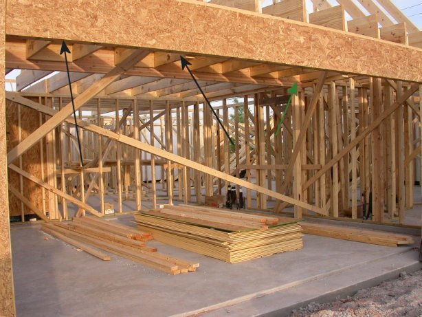

Here are a few pics of the garage when they were building our house....the studio is above.....
