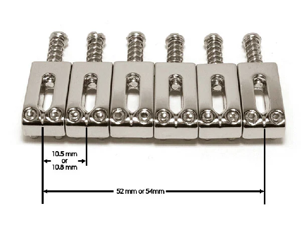

Because some sets are designed for a 52mm string spacing and some sets are designed for a 54mm spacing, some have 55mm. There are other string spacings that fender have used but those are the most common. I'm pretty much certain you need the 52mm but I can't be sure without more info.
You need to find out what your guitars intended string spacing is and fit a set that the same or narrower.

Okay. I've measured from the groove in the Low E barrel to the groove in the High E barrel and it's 55mm. The distance between the left-most side of the Low E saddle and righter-most side of the High E saddle is 65mm. Does this tell you anything?
55mm is the figure you need. It's more likely 54mm as thats a common fender spacing as I mentioned above. I assume these are the original saddles? If so you need to replace them with saddles that are listed as 54mm string spacing.
Take a look at the attached image. 2mm may not seem like a lot but it can throw off the set up quite a bit.
Thanks Mutt. I've been trying to find some 54mm-spaced saddles online, but the majority of vendors don't actually list width. I'm considering this as a straight swap; I think it has 54mm (2 1/8"? )spacing and I think the gold looks pretty nice.
