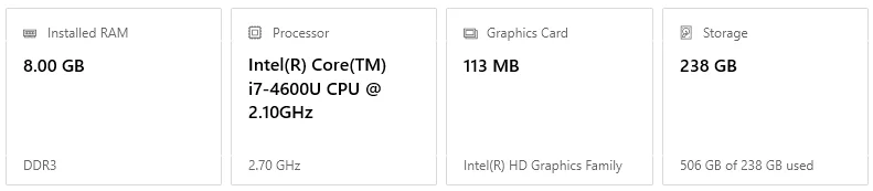

Sounds like you've thought about this more than me, but just to give you something to go from, this is my laptop's chipset from 2015, and it's able to run Reaper with heavy FX no problem until I get into the 30-40 track range. (After that it really chugs.)
