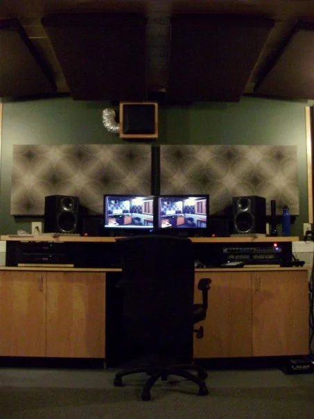

Here is a recent pick with the desk installed.

Hey man, this thing looks great! Give me hope for my future (looking to buy a house in the next year!). I'm wondering if you can go into a little detail on the diffusers you made for the plug. What material did you fill it with and did you measure it all our or just randomly fill it?

i`m now totally inspired to rebuild/ treat my new studio (the bigger spare room! lol)
amazing work.
love the choice of fabrics
