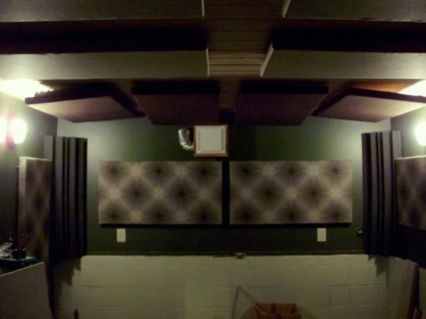

More progress means more pics!
Hello all,
Another update on my "Studio Build"
Got a bunch done the last few days...in between all my holiday plans.:rolleyes:
See all photos here: https://homerecording.com/bbs/album.php?albumid=78
Getting so close now!
Thanks,
Scott.

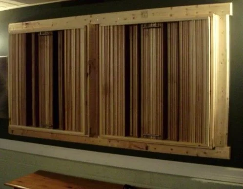

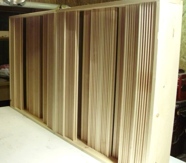

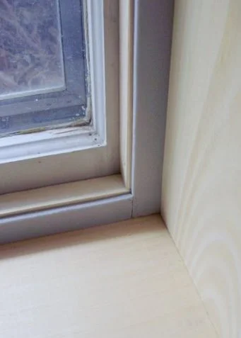

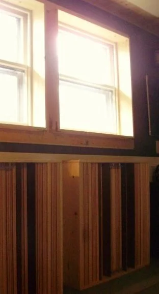

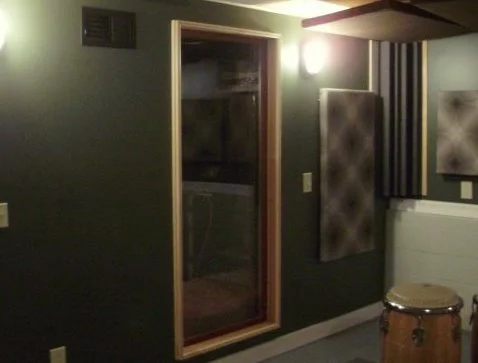

Another update!
Really pushing hard to get the treatment phase of the main room completed.
I built up some window plugs, all layered up with drywall and hushboard...these things are heavy!...as they should be.
You know what they say..."Good window plugs make good neighbors."
Visit my album to see some of the process.
Enjoy!:D
Scott.

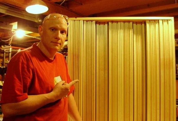

Window plug!
...with one of the plugs.:D
Scott.

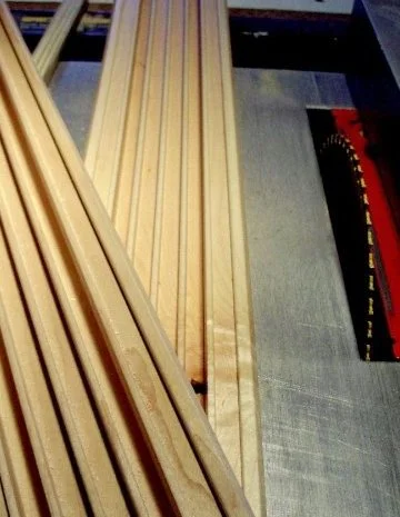

Looks great. Was there any frequency calculations involved? At first I thought you were using stock door molding or something, but up close, that doesn't look like a stock profile. How did you come up with that?
I LIKE. :D
I LIKE. :D
Thanks!
Heres some info...
Hardwood Diffuser, used to produce a diffused scattering of high frequency sounds without muffling. Grooved channels in the surface are a sequence of 7 elevations based on quadratic theory and the work of German acoustician M.R. Schroeder. Normally you build up panels of this stuff by placing planks side by side along a wall. I acquired a bunch of 30-40" scraps of this stuff when I worked at an architectural interior and cabinet shop. Been saving a pile in my garage for about 3 years, now, finally get to use it.;)
Heres a couple of links that inspired me.
http://www.customaudiodesigns.co.uk/diffusers/diffract.htm
http://www.janmyersassociates.com/manudet/documents/kineticshitonediffpanels.htm
Thank you,
Scott.
That's awesome, I can't wait to see the final product with all your gear in there!
Oh boy!
Ready to rehearse in there tonight! Champagne and stuff in the wait.
So psyched...my congas sound good in there...can't wait to hear the rest of the band. This weekend I'll start moving my desk and gear in.

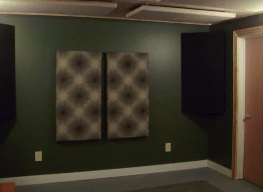

Looks absolutely amazing!!!
Are you going to paint the diffusers and wood parts next to the lenards bass traps? I would but thats just me. The ceiling is the most wood I could do. Hehe....
Once again, such a good job!!!
Thanks, friend. The diffusers are solid maple with a clear satin lacquer finish, so I don't want to paint those, but the trim and jamb extensions around the window are pine and may get painted or stained. The trim on the Auralex corner traps actually holds (pinches) the traps into the corner (no adhesives) That too is solid maple and just too swanky to paint ;)
We rehearsed in there last night, it was surreal, and sounded great... exceeded all my expectations.
Thanks everyone!:)
Scott.

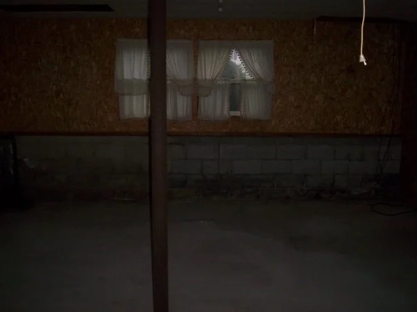

Before and after...
"Before" is the day we got the keys to the house.
"After" are photos from a few days ago.
Moving the gear in this weekend, a few more pics coming soon.
Enjoy!
Scott.

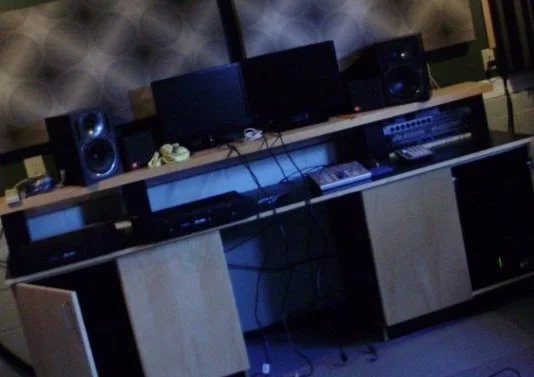

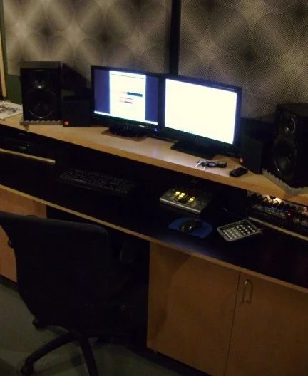

Bringing in the electronics.
Got my workbench in this weekend and started testing.
More to do, like finishing the iso-room :rolleyes:
Scott.

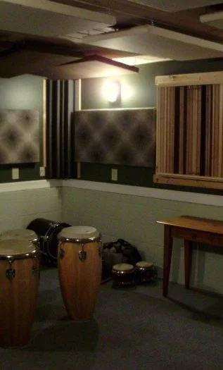

First real test.
Hello again, Thank you!
I rehearsed my band in the new space last night (Latin Soul/Salsa). I set up 5 mics in the 12x18 space. Vox, Sax, Timbales, Conga, and Kick. I DIed the Bass and the Nord came in stereo for a modest total of 8 inputs armed. After levels we're set, we ran a few tunes and then listened. I added a faint verb on the master bus along with a little comp, nothing too involved, and it sounded clean and clear. I soloed each mic curious about spillage, we we're all amazed with the amount of isolation each mic had as they we're in such close proximity. Mic placement and the room treatment had much to do with it I'm sure. The outcome of the little recordings last night exceeds all the expectations I had on my gear and the room...shoot, the entire build for that matter...and what a relief that is, let me tell ya ;)
So now, the REAL fun begins...wait...is this thread "dead" now that my build is "done"? Maybe I need to start a blog. :rolleyes:
Pictured: Window plugs
ROCK ON! \,,/ (-.- ) \,,/
Scott.
