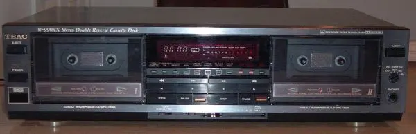

There's certainly some truth in that. A few weeks ago I installed an "emergency programme unit" at our Gore transmitter site to provide a backup during satellite outages. It is based around a mint Teac W990RX that I bought for NZ$40 (US$25 or so at current exchange rates) last year (see attached). When Optus B1 decided to go AWOL for 13 hours last week the on-air sound quality we were getting from chrome tape with dbx from that unit was audibly superior (even over FM) than our normal source, a 128kbps MPEG stream from a Comstream ABR202.

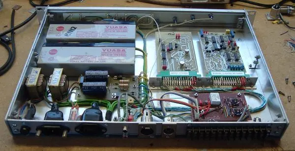

You've got me started now....

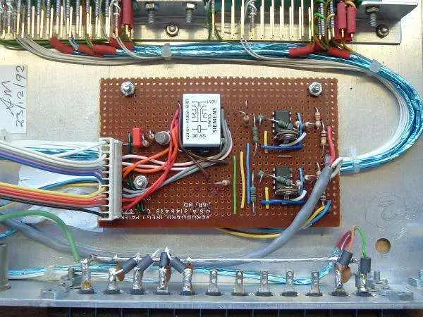

This is the guts of the EPU, a Radio NZ programme switcher/silence detector, originally designed to allow remote switching from a network feed to a local studio and emergency programme content to be injected at the transmitter site. Was mono for use at AM sites. I have modified it to switch stereo (for FM) - made a stereo unbalanced-balanced and level converter and piggy-backed a 4PCO relay to the existing logic, with the original silence detector fed from the left channel. Just replaced the 3 pin XLR's with 5 pin ones so I didn't have to do too much creative metalwork.

This is a closeup of the mod.

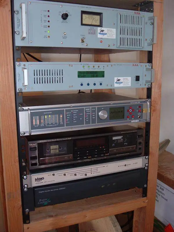

Finally, this is everything installed on the site. For this kind of emergency use Rhema are starting to use MP3 players and in some cases CD, but the humble cassette deck is still the most reliable - after 13 hours of satellite disruption this was about the only site still running.
