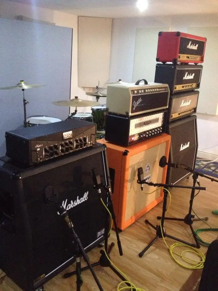

I've been experimenting more with the Kemper.
I got an opportunity to really test the Kemper today at a proper studio with some good microphones and obscene speakers.
Picture: tFNl4S0.webp lots of Marshalls!
They really highlighted the difference between the amps and the profile. The Kemper tended to add more low end and roll off high end as well as gently compress the sound. At the same time, the Kemper de-reverbs every signal you put into it. We first tried it through a room mic and it cut the reverb tail flat and made the sound more present.
We then ran it through a chain with a reverb in it set to over 5s of decay and the profile still came out dry.
It seemed to enhance high gain tones in a rather pleasent manner but didn't keep it quite together on the crunch and clean.
Picture: lots of Marshalls!
Picture: View attachment 94357 lots of Marshalls!
Is it weird that I can name those Marshall heads just by the knob layout?
