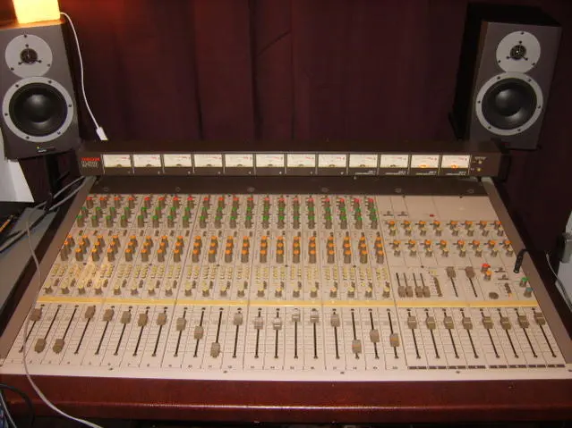

Hello Sweetbeats,
First of all I read all the posts of this thread an I must compliment you on your clear documentation of the cleaning process. Very informative!
I just received a M-520 as well. I'm used to ITB, but with this console I want to send the outs of my firface 800 & 2 AI3 interfaces to the ins of the tascam. I have some problems with testing it. The headphones are connected and I want to check the channels. I followed your instructions in post #258 but no succes yet. I have to mention that not all jumpers were included so i have jumpers connected on channel 1-16 en buss 1 (which is the buss I am trying to monitor). Does it matter that the other busses and channels 17-20 are not jumpered when I try your explaination from post #258? I think the headphone amp works as I can hear a slight noise.
Hope you have some more tips on how to test the unit.

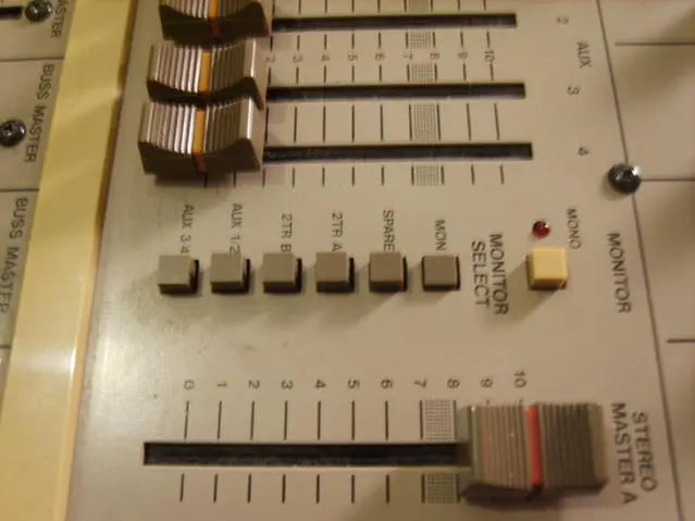

In the monitor section only MON is pressed down (so not MONO above). The monitor channel 1 knob is at 12 o clock. And buss 1 fader as well as the fader for the channel are in the grey area.

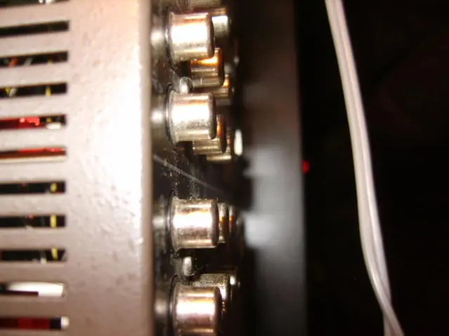

How do the jacks look? Are they nice and shiny or oxidized in appearance?
Can you put up some pictures?
When you made your 1/4" to RCA cable, is the 1/4" end TRS or just TS? If it is TRS did you make sure to solder the ring and shield of the TRS plug to the shield of the RCA, and then tip to tip?
There are several leds flickering so corrosion did affect the leds.
The cable connector is TS type. I triour ed another one I found which is Pre-fab.
The RCA's look quite corroded (not too shiny, a little matte). I try to make some pics tommorow.

The mixer itself doesn't look really abused. Quite good optical condition (That's the reason I bought it and didn't know before how to recognise corriosion). Also PSU doesn't look bad.
All leds wok but some will flicker.

If the jacks on the back show oxidation, it isn't out of reach to think that internal connections could be oxidized. We're not there yet, but sometimes on this older gear, in fact it is not uncommon, for a lot of problems to be solved simply by disconnecting and reconnecting internal connections and applying contact cleaner as you go, but do the above checks/tests first and also check to see if you have any audio passing from channel input to ACCESS jack.

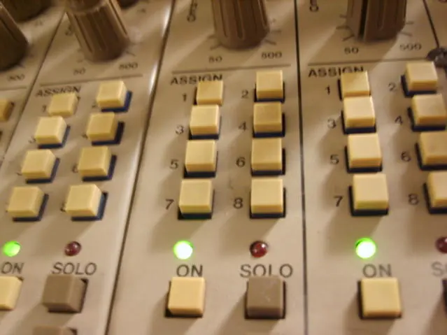

I made pics but no permission too upload them.:(
And the images overview, RCA state and buss settings.
