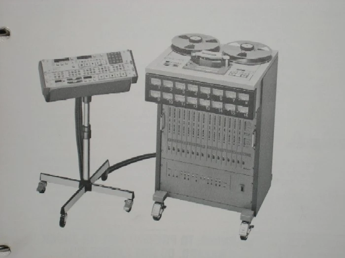

Can't find any good pictures of the ATR-60's connections.
I'm hoping the ATR-60 has some sort of transport control (probably either a 9 pin serial cable or a 50 pin parallel port). Do either of those ring a bell? The face that the ATR-60 pulls up as a preset in my ES-60 gives me some hope, but I think I'm going to have to just get my hands dirty and figure it out once I have the unit.

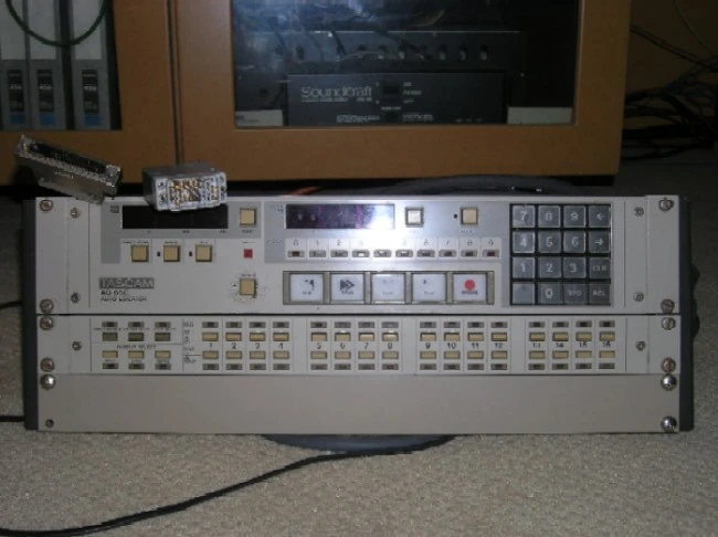

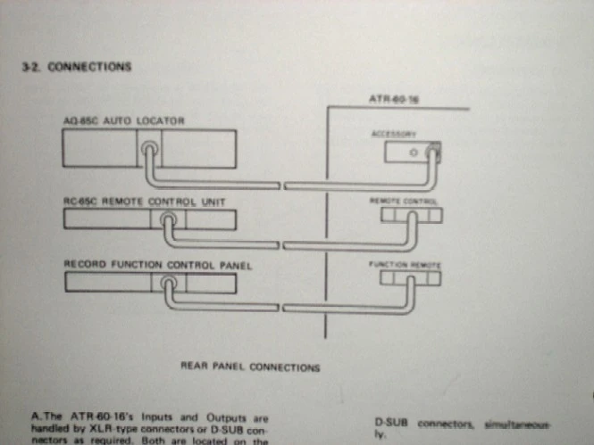

The transport controls are all on the ATR AND on a standard/basic Remote Control Unit (RC65-C) which usually was mounted on a roll around stand along with the Record Function Control Panel and connect to the ATR with a type of D-Sub plug. An alternative to the RC65-C was the AQ65-C Auto Locator which is a more comprehensive combined transport/locator unit which connects to the ATR's "Accessory" socket with an Elco 8016 connector.
It is essential that your ATR comes with at least the Record Function Control as this is where you arm tracks, etc.
I'm still on my first coffee for the day so I hope this kinda makes sense and if time allows, I'll try and take some pics and post them up later.
ChrisO :cool:
OK, sorry for the pic quality, two were photographed from the manual.
First is the ATR and the Roll Around remote stand with the AQ65-C Auto Locator, the Record Function Panel and the RC65-C Remote Control Unit at the bottom. Second is the connections diagram from the manual........ and third is my AC65-C and Record Function panel with the D-Sub and Elco plugs on top.
