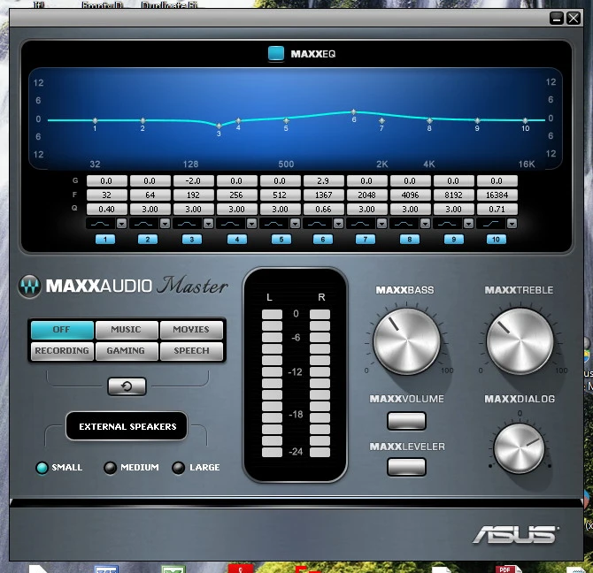

If you do opt to use the computers onboard soundcard and its associated software features, be sure to look at the EQ and other settings that may affect how the audio is reproduced through monitors or headphone. My ASUS PC uses Waves MaxxAudio for the RealTek soundcard and its settings other than 'OFF' can make it really difficult to mix or EQ tracks that sound right anywhere else.
I have a set of small powered M-Audio monitors plugged into the line out of my PC and they work well and the headphone out on the PC drives Sennheiser HD280's and Sony MDR-7506's fine.
I do have a Behringer UMC404HD interface and it does come in handy if I want to add or replace a track in Reaper that I had originally done in the Tascam. An interface is a useful and handy tool that is worth having around.
