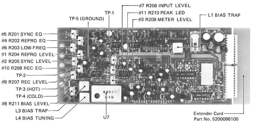

I'm going to have to recal the peak LED's on the BR's VU's because even when they are going nuts the material coming off the repro is still clean. I'll do that when I get around to doing a complete cal on the BR. BTW I'm using fresh SM-900.
If you figure out EXACTLY how to do that, please let me know. I think my MS16 peak leds are supposed to light at somewhere around 15 dB over (can't remember what voltage). I never could figure out why I couldn't get them right.

If you figure out EXACTLY how to do that, please let me know. I think my MS16 peak leds are supposed to light at somewhere around 15 dB over...
Check and see but I betcha its trim pot R210 on the amp cards. Ethan or others can confirm, but your amp cards are the same as what I had in my 58 and that was R210. You see the row of 3 trim pots that are back behind the first two rows? R210 is the one in the middle of that back row. Its possible to get to it without an extender card but its a bit of a bear.

Yes, that is correct. And it is a PITA to get them all triggering at the same time.
Your best bet (this is how I do it) is to make a cable that splits your signal generator output into 16 RCA (or 8 for an 8 track) plugs so that you can send the same signal to all inputs at the same time. If your generator does not have the power to drive that many inputs you can run the signal into a small power amp and then to all the inputs.
Monitor the signal voltage at the point that you split it and adjust it to the value speced in the manual. In theory all inputs now have that same voltage (use the same cable and cable length to the inputs, yes that is ober kill but ...)
The peak led circuit is a voltage comparitor which has hysterisis which means that it turns on the LED at (oh say) 1 volt and turns it off at 0.95 volts. What this means is that you should set the voltage that just turns the LED on and if you go to far then turn is most of the way back and try again. But I digress.
OK, with the desired voltage going to all inputs you adjust the pots little by little until the LED just turn on. It does not hurt to take a few tries on each channel. Then once you have them all where you want them you change the voltage from the generator to be less that peak and slowly increase the voltage to see how close you got them to each other. Don't worry id some are way off the others.
At this point I mark the ones that are too far from the others and reset the input voltage to be where half of the led are lit (excluding the ones that I'm going to readjust) and then adjust those that need it to just come on.
Then recheck by changing the voltage to be sure that they all light at hear the same time. I can get a little anal about it in trying to get them all to the same "on" point but generally you don't have to go overboard here. If they are within 1 dB of each other they are quite close. Or if they are all on at the on spec voltage and all off at the off spec voltage youu are golden.

Ethan,
Thank you for the very detailed reply. Yes, that is why I had given up on trying to get the peak lights to operate as intended. For certain the manual gives a procedure, but I found it just didn't work to well. But I'll bet the method you have described will do the job. Thanks again.

Glad to be of help. Nice to know that such a long post is useful. I was worried about that.

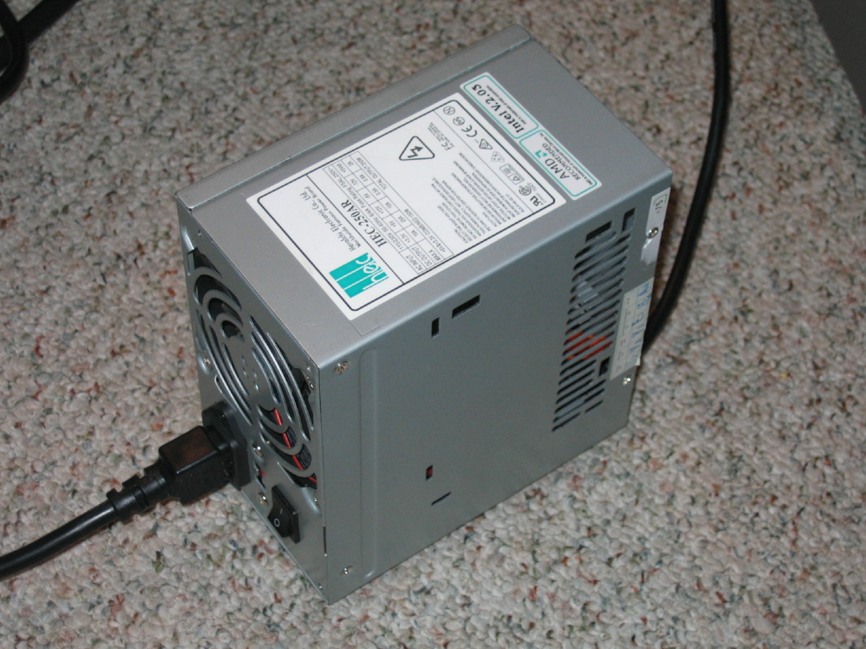

The fact that the TimeLine Microlynx synchronizer is powered up is a happy thing for me. The PSU was hosed and they are totally unobtanium. I wasn't sure what to do at first because the original PSU uses a DIN-5 cable (aka MIDI cable) for power interconnect and it carries two grounds and +5 and +/-12VDC rails. Well, a standard ATX computer power supply has those rails. I just had to figure out how to hack the supply so it would turn on when not connected to a computer motherboard, splice in the DIN cable, fab some output protection (thanks gain for the help coming up with that, Ethan), and put some rubber feet on it. Voila, benchtop aftermarket Microlynx PSU, and fan cooled at that:
Nice fringe benefit of using a computer PSU: the power is really clean.

Nice work using the ATX PSU for your MicroLynx! I was just thinking, if you only need your MicroLynx for syncing with the computer you might as well power the synchronizer off the computer's PSU, after checking that it can handle the additional load. No need to mod the PSU for powering on without the PC then, just an additional cable, as the unit would only be used in combination with the DAW. Then you wouldn't have the PSU lying around and the setup would be even more compact and portable. Still a good thing to have the additional unit for backup, when you want to sync with something other than the DAW.

Hm. I never even considered tapping off the Dell's PSU. That's something to think about, though the Microlynx's PSU perches nicely on the back of the Yamaha i88x, which is, like, 14 inches deep so it makes a nice shelf there. Plus, though I *think* the Dell PSU could handle it, its an older system with a 220W supply, and of course because its a smaller form factor the case of the supply isn't standard ATX. I knew I was compromising some things by setting up using the smaller case but I like the compactness and it was super-cheap. I have a really nice hot-rodded computer that i've used for a few years but my priorities have been drastically shifting and that has become the family PC...I'm hardly ever in the studio and it was just wrong to have that powerhouse sitting nearly all the time. The Dell in the rack was super cheap and I used available spares to beef up the RAM and I've got a dual 2.5 inch SATA RAID drive enclosure that fits in the space of a 3.5 inch bay for the audio tracking drive and then (since there is only one SATA port) I'm using the IDE port for the ATA-133 system drive and the optical drive. The smaller system is nice in this case because there are less hardware IRQ's needed. I know the XP platform manages the IRQ's much better than past MS OS's but I still run into issues with laptops that always seem to lump the GPU and cardbus and USB channels together. With the OS tweaked the way it is I'm only using 126Mb of RAM with the Yamaha mLAN drivers and Cubase running. And data transfer rate, in theory (as measured by diagnostic software) to the RAID array could handle over 40 simultaneous tracks at 24/48...well over double my inputs so that's good data bandwidth...and even though the processor is a P4, I did a test song with 4 virtual instruments running (all long sustain ambient pad-type VI's) and some effects and a complex mastering plugin and I just started to get some dropouts with the buffers set to 4ms latency throughput so totally adequate for my needs. Pretty good for an old P4 box. Anyway, the Dell is running pretty fully loaded so who knows how the supply would tolerate driving the Microlynx, but thanks for opening up the idea. May come in handy. :)
