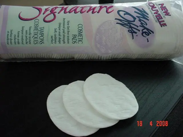

BTW, you should use those low lint cotton pad makeup removers for cleaning the heads and metal parts of the tape path and lint free cloth for the pinch roller. It's much easier, quicker and more effective than those cotton q-tips. They're fine for a cassette deck but not open reel. Trust me, go for the make up removers! :D;)

On the cotton pad makeup removers, are you talking about the ones that are smooth and kind of quilted looking? Do you just put a pad over the mouth of the head cleaner bottle and tip it to get the pad wet with the cleaner? What is a good lint free cloth for the pinch roller. A scrap of t-shirt?
Using the q-tips has been a pain so I appreciate the suggestion.
I contacted US Recording Media where I bought it from and they tried to tell me it was bad tape path alignment ...... I hope they don't give me any hassle over this... :confused:

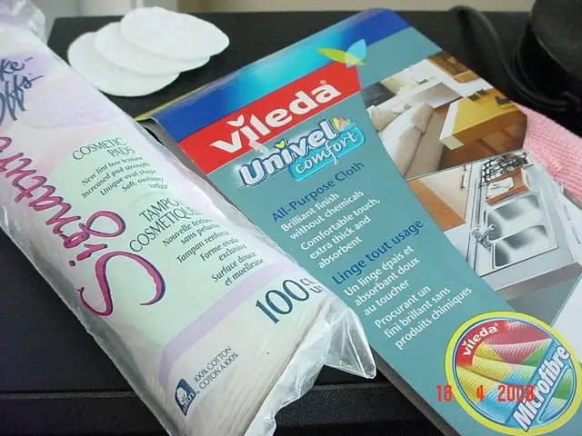

Yes, any of those 100% cotton 'make up removal pads' will do. I use those exactly as you say, just making sure not to have any alcohol drip. They can be oval or square but their size is sort of like that of potato chips.
For the pinch roller I use one of those microfibre cloths and I dampen the edge with a bit of warm water and use that for cleaning the pinch roller. But of course you could also use a cotton t-shirt or even a towel but I like the material to have those noticeable fibers which do a bit of a better cleaning than the very smooth cloths. I've attached a photo of what I use but they only differ in brands and such....
