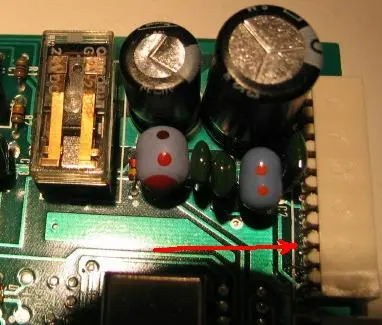

AMP CARD ISSUE

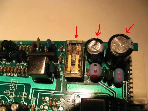

It’s usually the little things with the amp card. The contacts on both sides get oxidation buildup, bad capacitors and/or bad relays.
Sometimes DeoxIT isn’t enough, so try a fine brass wire brush (about the size of a large toothbrush) along with the DeoxIT. You can get them at hardware stores or in sporting goods departments that have gun cleaning supplies.
The relays on your amp card are the non-sealed type, so they will get oxidized. The clear plastic top lifts off so you can clean them with DeoxIT as well. It’s best to replace them with a sealed type, but cleaning them will give them some more life. When cleaning relays, apply DeoxIT and turn card upside-down right away, as these cleaners can damage some plastics.
The two electrolytic capacitors right next to the relay are more likely to fail than others, so you may fix your problem by changing only those.
One final note on the cards – a lot of manufacturers during 80’s and 90’s coated the solder side of circuit boards with a spray that was supposed to protect the traces and solder points from corrosion. Only trouble is this substance ended up breaking down over years and became conductive. It can cause all kinds of buggy ghost-in-the-machine behavior that will have you pulling your hair out.
I remove it with another gun cleaning product called Birchwood-Casey Gun Scrubber. Only try this if all else fails to fix the buggy amp card. You can usually detect this problem if the circuit board feels tacky or sticky to the touch.
You hold the circuit board in one hand so the edge faces the ground (wear rubber gloves) and spray the solvent onto the back (solder side) of the board until all of the sticky brownish residue has run off. Don’t spray it on the component side or get it in any pots or trimmers.

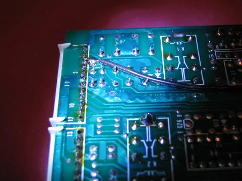

By the way, I forgot to mention something in my posting frenzy... cold solder joints. On those types of amp cards you may encounter “broken” solder joints where the pins connect to the board. It will cause intermittent problems. Since one of the issues seems to follow the card I should have mentioned that.
It’s an easy fix – just turn the card over so the trace side is facing up and touch a soldering iron to each pin until the solder around it liquefies. (There are traces and solder points on both sides of that board, but heating the tip of the pins on the bottom side should do it)
Adding a little solder won't hurt.

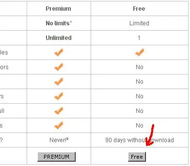

Looks like you have to join up to view the files. Is that right ??
If you're not a member of rapidshare you just have to wait a few seconds and can only download one file every 8 minutes, but I got around the 8 minute thing simply by clearing cookies and temporary files in IE.
Click on free download and it will walk you through.

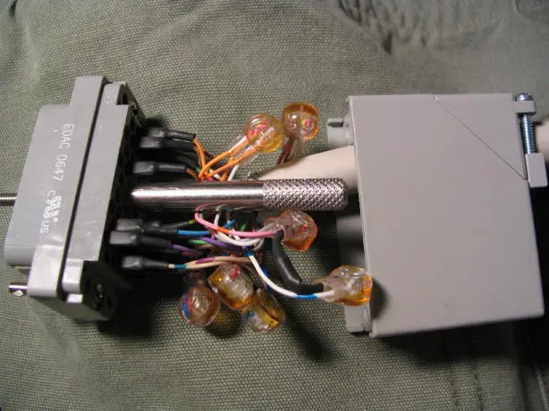

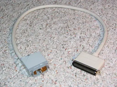

Finished assembling my CN50 to ELCO sync cable last night! I still need to do a final circuit test to make sure nothing went array on assembly, but it came up very well. I'll try to get some pictures posted.
The finished sync cable...
A couple pics attached...
Lessons learned:
1. If you're using really small guage wire like me (28ga.?), you will need to have some sort of strain relief attached to the ELCO pins...I used small heat-shrink tubing and used the soldering iron to shrink it. It worked really well.
2. You may want to get the depinning tool just in case you make mistakes...a lot of mistakes (like not putting strain relief on the first 8 pins and then the wires start snapping...:eek:). Or if yer like me you'll find something will work...like a jeweler's screwdriver... :cool:

Hey… nice job on the cable by the way.
Thank you!
Lesson learned #3:
Don't use telephone butt splices unless using solid core wire.
I had these nifty splices on-hand and I thought they would work great because of their size and shape as well as the easy assembly...plus they have petroleum jelly inside and I thought "these connections will last forever!" Well, I ran my unloaded circuit tests on all conductors of the cable last night making sure all the routing was correct and no shorts...couple bad connections and it is the result of the splices. It looks like it is damaging some of the 28ga. strands causing resistance issues.
I'm going to replace them tonight with traditional solderless crimp connectors.
Hopefully that will work better. If so, then I'll begin work on the MASTER I/F cable to connect up the 48 with the 58 when I want to sync the two together as opposed to sync'ing the 58 to the DAW.

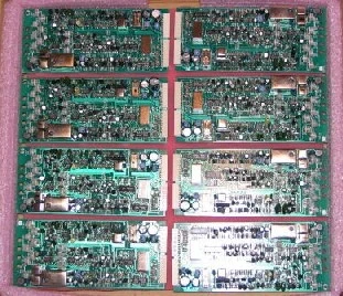

Okay...
Resoldered the multipin connectors on all 8 amp cards and cleaned all the relays. The relays all look *really* clean, so I'm not sure if I did any good...
Picture of cards ready to go back in below. Hopefully I'll have the chance in the next couple days to remount them in the 58 and see if I killed anything...:rolleyes:
Also replaced the unsatisfactory crimps in the sync cable. Came back together really nice.

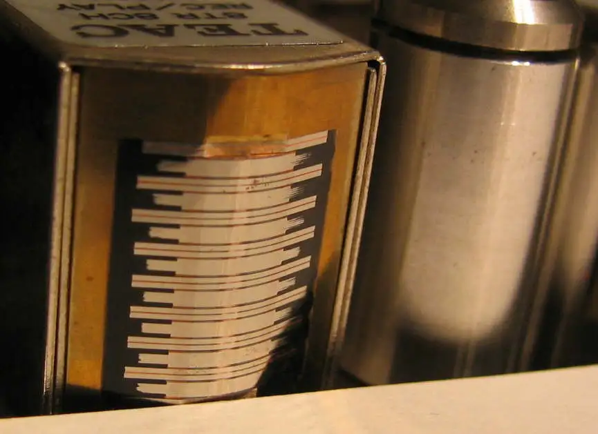

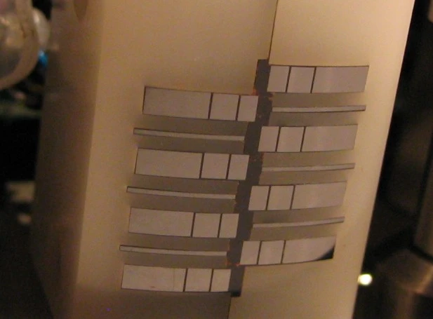

4. Loaded my relatively fresh reel of RMGI 911 tape, played the tape until about 26:00, and then did a mix of fast REW, REW spool and play back on to the RMGI reel. Below are pictures of the sync and erase heads. Is what you see unacceptable? You can see oxide between tracks 1 & 2 on the sync head, also on track 7 and in between tracks 7 & 8. In that same picture you can see bits of oxide on the upper portion of the scrape filter. You can see oxide loaded up in the gap on the erase head. ALSO, when I am cleaning the erase head its like the swab catches in the center of it...like it has sharp spots or something. It *looks* fine to me, but its like stray fibers of the swab catch. Is that normal?

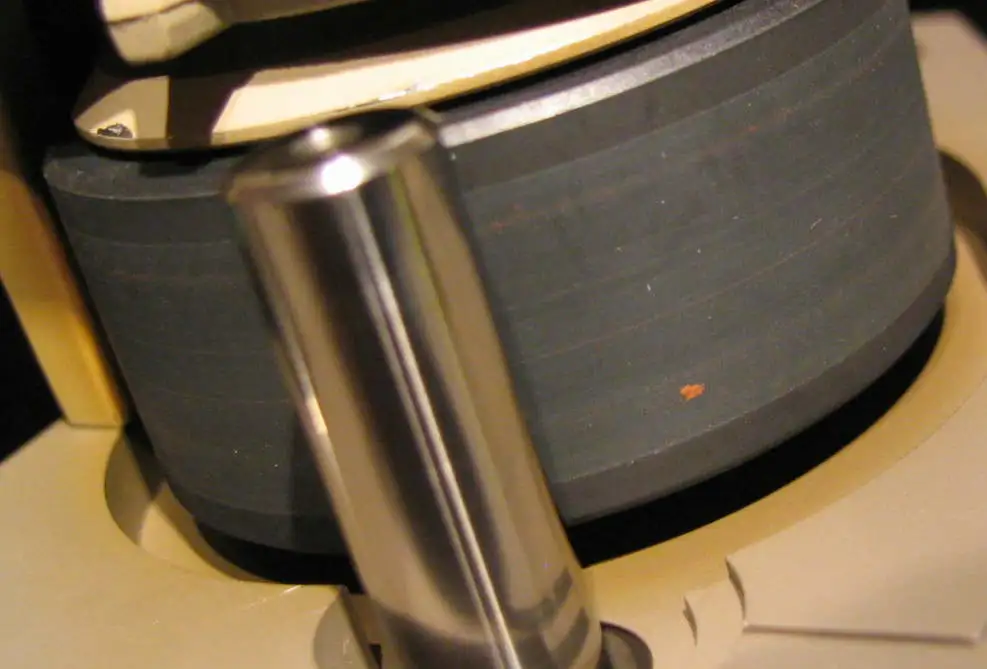

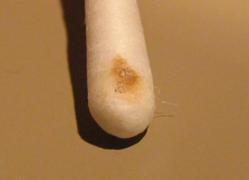

A couple more pictures...
Pinch roller (which was nice all matte black before running the RMGI tape)...nich chunk of oxide...
The swab in the second pic is what I got off the initial swab of the scrape filter...I got two more swabs like that before it started coming clean.
So is this normal, and if not how do I go about getting my tape replaced?
