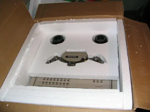

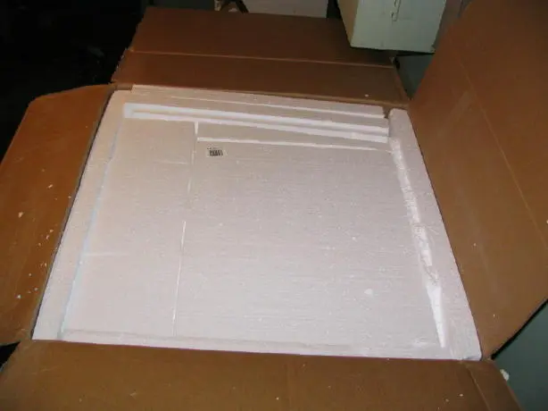

Pics of the packing job on my "parts or repair" 48...
Cory, I must say I'm impressed by the packing. The seller pretty much recreated [to a reasonable degree] the factory packing [minus the protective plastic bag ;) ]. It's miles ahead of the usual packing jobs I see [and corresponding shipping damage], so thanks for posting this.
Say, does the bottom [also] have a cutout for the connectors or is it just a flat panel?
This type of packing [for more critical, working units] plus strapping it to a wooden pallet, shipped freight, would be da bomb!:D
No cutouts on the back. The feet on the back made their own holes. :rolleyes:
Would have been nice to do that, but considering everything else I'm not complaining. I ended up PayPal'ing the guy another $25 for shipping.
