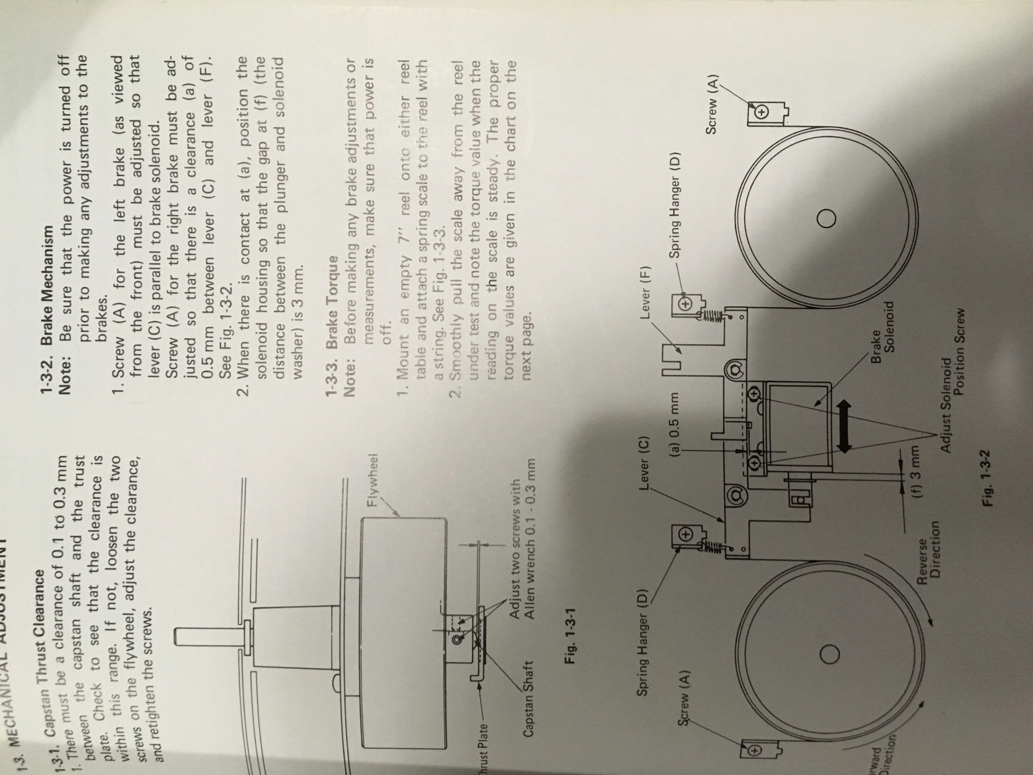

My Brake (during record/playback) only seems to be dis-engaging like 80% of the time. For some reason others times it does not.
Any advice?
I tried adjusting the mechanism (screw A) as the manual suggests to get the 0.5mm spacing....but no luck yet.

Ok well I think things are looking good here......the brake issue seemed to be purely a mechanical one.
I adjusted the solenoid a bit and it disengages every time now :)

When you said "no luck yet," my first thought was to refine that statement a bit. Is it (a) that you were not able to get the spacing specified in the manual; or (b) you got the right spacing but that didn't help. If you got the right spacing, you'll have to dig further. Since you said that the brake releases 80% of the time, I think that the person who wrote about the cushion becoming sticky is right on. If it were my equipment, I'd take the simple approach and just remove the cushion since it is not necessary for operation of the unit. In many cases, this equipment is connected by cables to something else so that no open mike is present, so the extra clank won't do any harm. I maintain that in this case removal is simpler than trying to clean the old one or find another item that will fit. If the cushion has started to deteriorate, cleaning might work only for a relatively short time.

  • adjusted brakes according to the instructions in the factory manual
