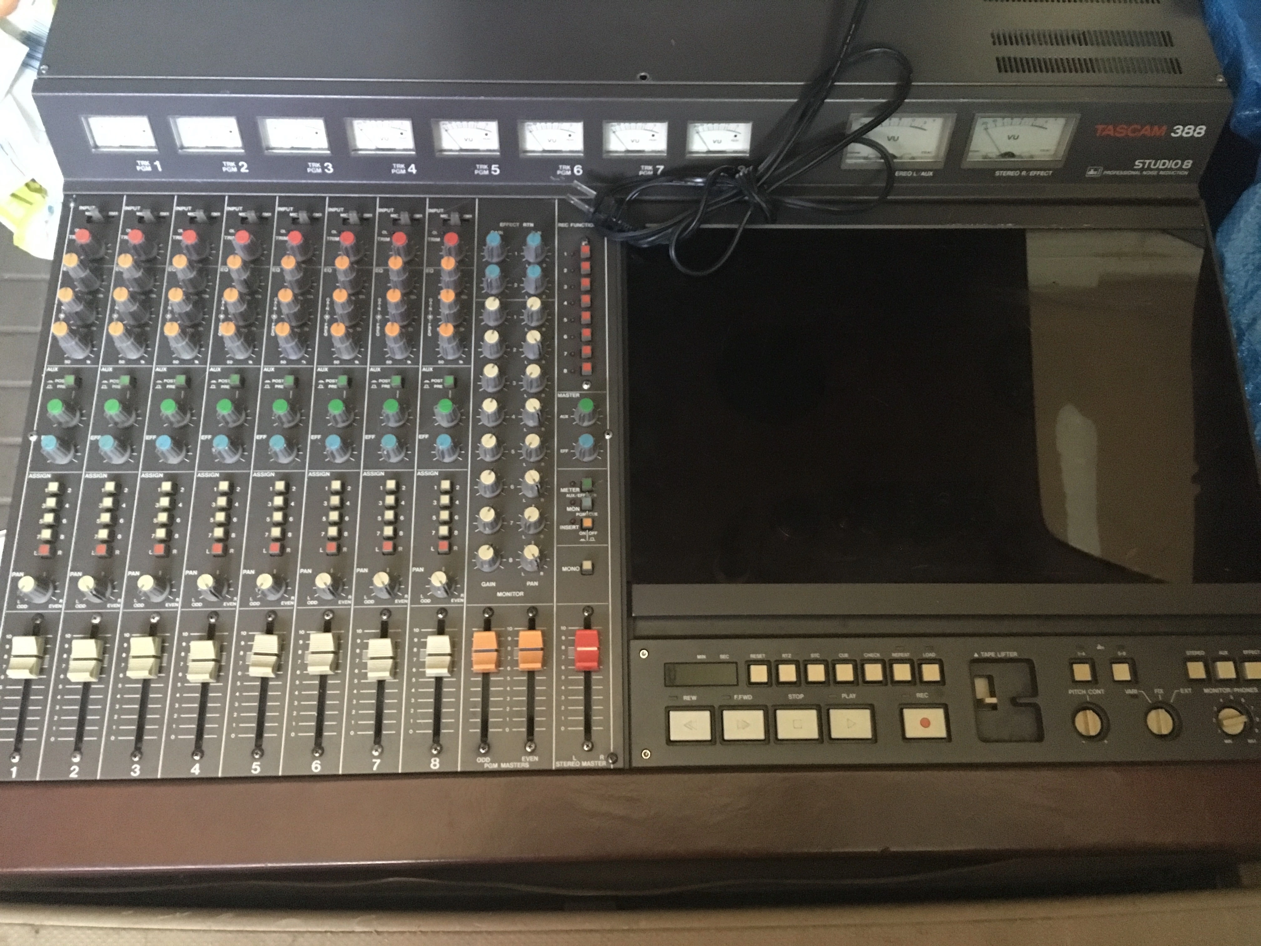

Finally took it home today! And then brought my other machine in for alignment."Basically you hit play, it engages then immediately stops. FF and RW do the same, often going "limp" after engaging (insert joke) and becoming loose in the path, coming off the guides".
You have lost the " 15 v nst supply". There is a 35v 300 ms pulse that energizes the capstan/brake solenoids.It ramps quickly down to a 15v "run" voltage.It could be as easy as a blown fuse-check them with a ohm meter not just visually- or a problem in the 15 v section of the power supply PCB.
