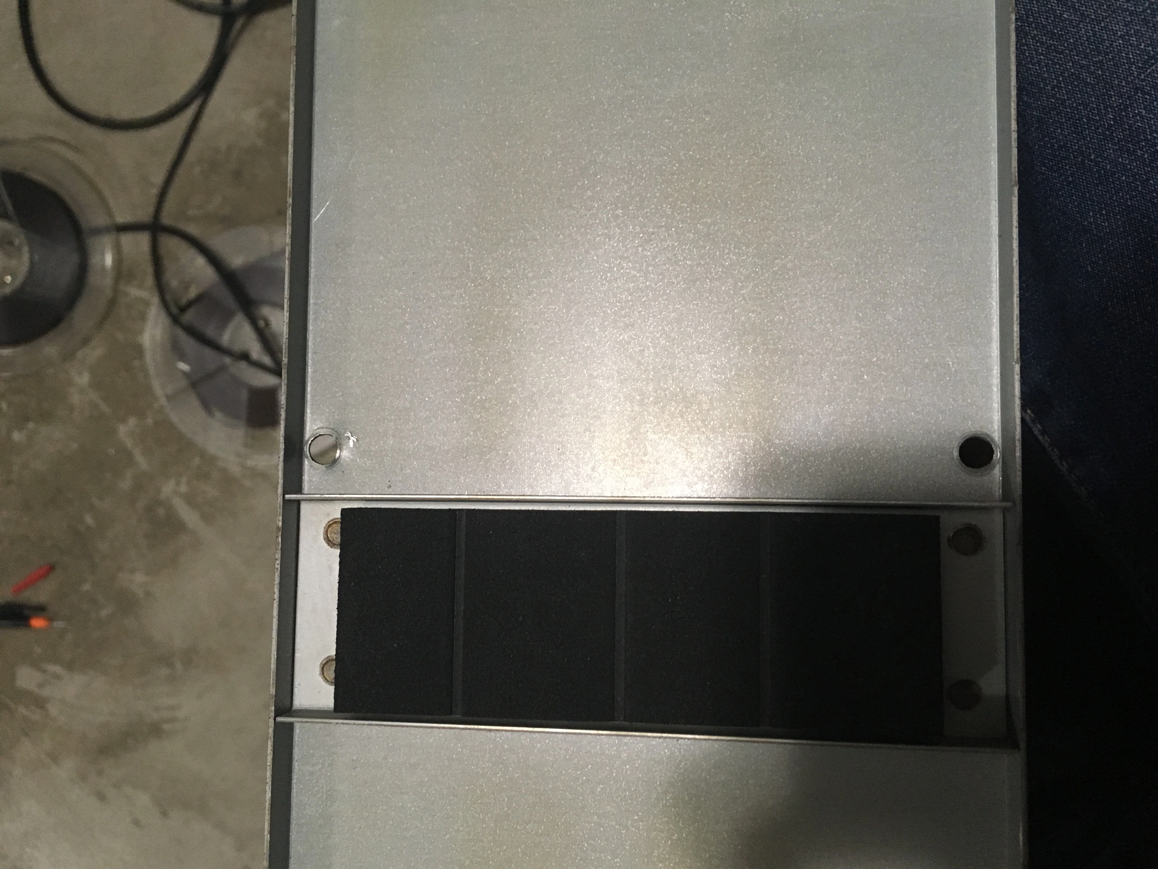

Flip the cardbay cover upside down, take a picture of it and post it. I think those are the spacers that should be press-fit into the cover for each of the 6 mounting screws.
Yes I think you are right. These appear to be missing from the middle of the card bay cover. The other 4 corners have the same spacers still. I bet these came loose because one of those screws was stripped and I had to use a bit of force to remove it.
I'm guessing these would have to be epoxied back on?
Yeah epoxy or maybe something like JB Weld.
