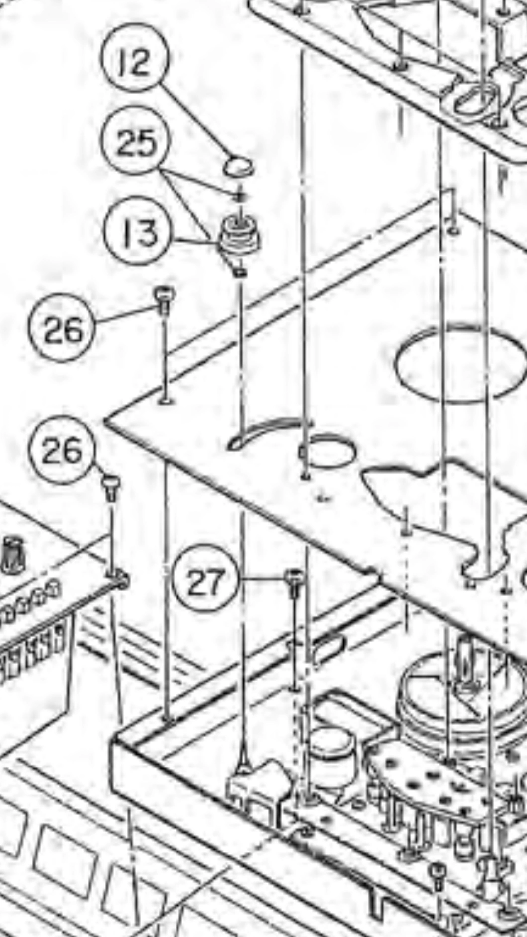

Unfortunately nothing happens when I lift the take up tension arm roller. Believe me, I tried every permutation of gently manipulating or adjusting all parts of the tape path that can be moved and this is the only point that seemed to change anything. I suppose I could try straightening the supply tension arm downward but I just want to feel like I know what I'm doing first. I'll check your channel for the video you mention.
Just so I know we're talking about the same thing, what I removed was a 1/8" inside diameter washer--which appears to be metal--that sits between the tape tension guide and the arm, is that the same piece? In any case I guess it does stand to reason that it's there to prevent direct friction between the guide and the arm. I hadn't considered what a temporary fix that may have been.
