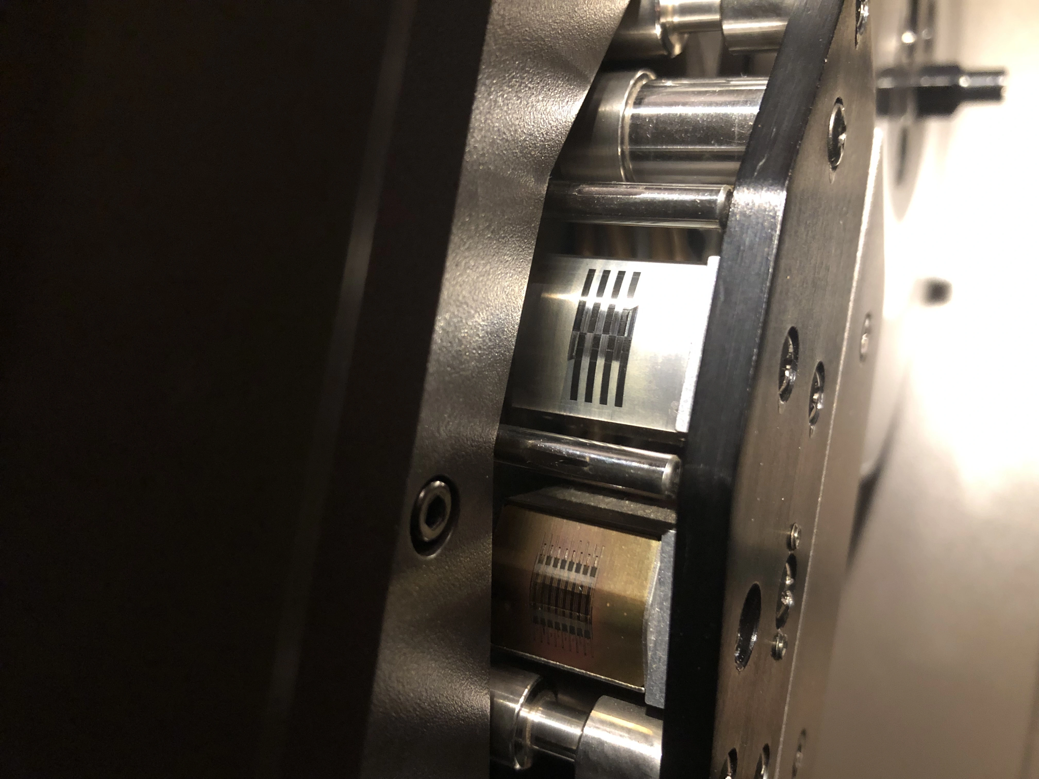

I'm posting a pic of the rec/playback head here in hopes that there may be a visible clue.

I think what's showing in that picture is a reflection of the top panel. I saw that too and moving the light source moves the dark spots. Definitely cleaned the hell out of the heads but I suppose another go around isn't going to hurt. I already do clean them and demag more often than the every eight hours of use recommended.

Okay on the pic of the head…the reflection. Can you post another pic or two without that reflection? Better light? And defer to getting the head in focus rather than getting close? I don’t know what you’re using to take pics but my iPhone 14 won’t let me get close, but if I have good light and stay back so it can focus on the small subject I can just crop and have a good image.
Now, regarding if changes to the reel table height or pinch roller or pinch roller pressure could cause a change like you’re experiencing, which is maybe a deflection of the tape downward in the path across the R/P head…yes. Long answer: each point in the tape path that acts as an upper or lower boundary for the tape, like the guides, for instance, also create pivot points if the tape is pressured into them. I can’t really explain it well, but I’ve experienced this when setting up tape paths and finding the tape heading the wrong way at one point and identifying it’s because of something ill-adjusted at a completely different place in the path. The tape can end up in a gentle ‘Z’ pattern through the path. I think this is more true the more narrow the tape. There is great variation in tape paths and how they are setup and handle this. It’s very complex. The 388 tape path though is pretty simple, and the transport is pretty gentle on the tape. So reel table height I would not expect to influence behavior across the R/P head, okay? I’m not saying it’s not possible, and I don’t have a 388 anymore to test my theory, but my suspicion is that’s not the droid you’re looking for. Tell me about your pinch roller. Tell me you did not refurbish the roller by getting one of those replacement tires…no judgment if you did, but I most definitely have opinions about that solution for a pinch roller rebuild.

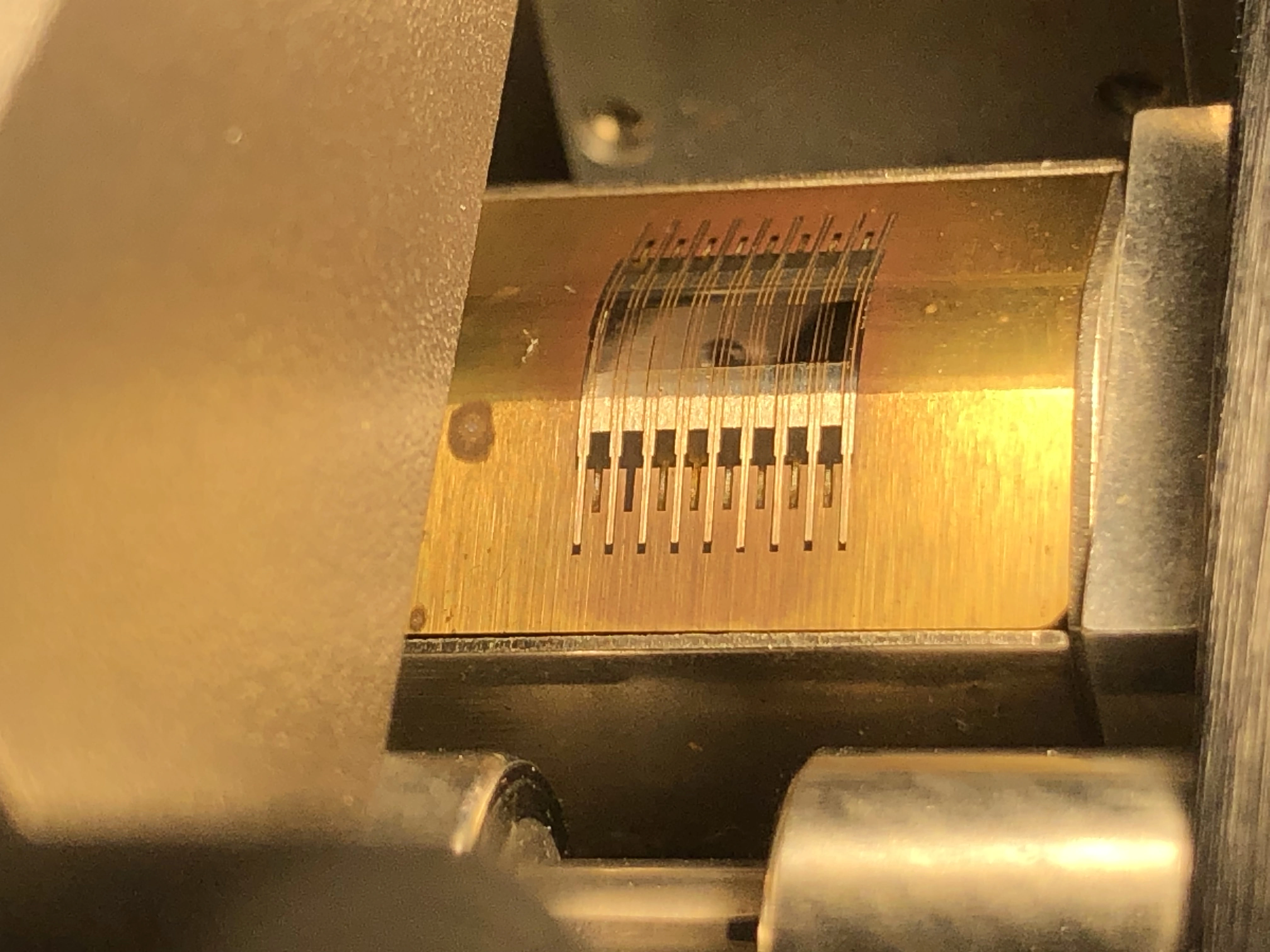

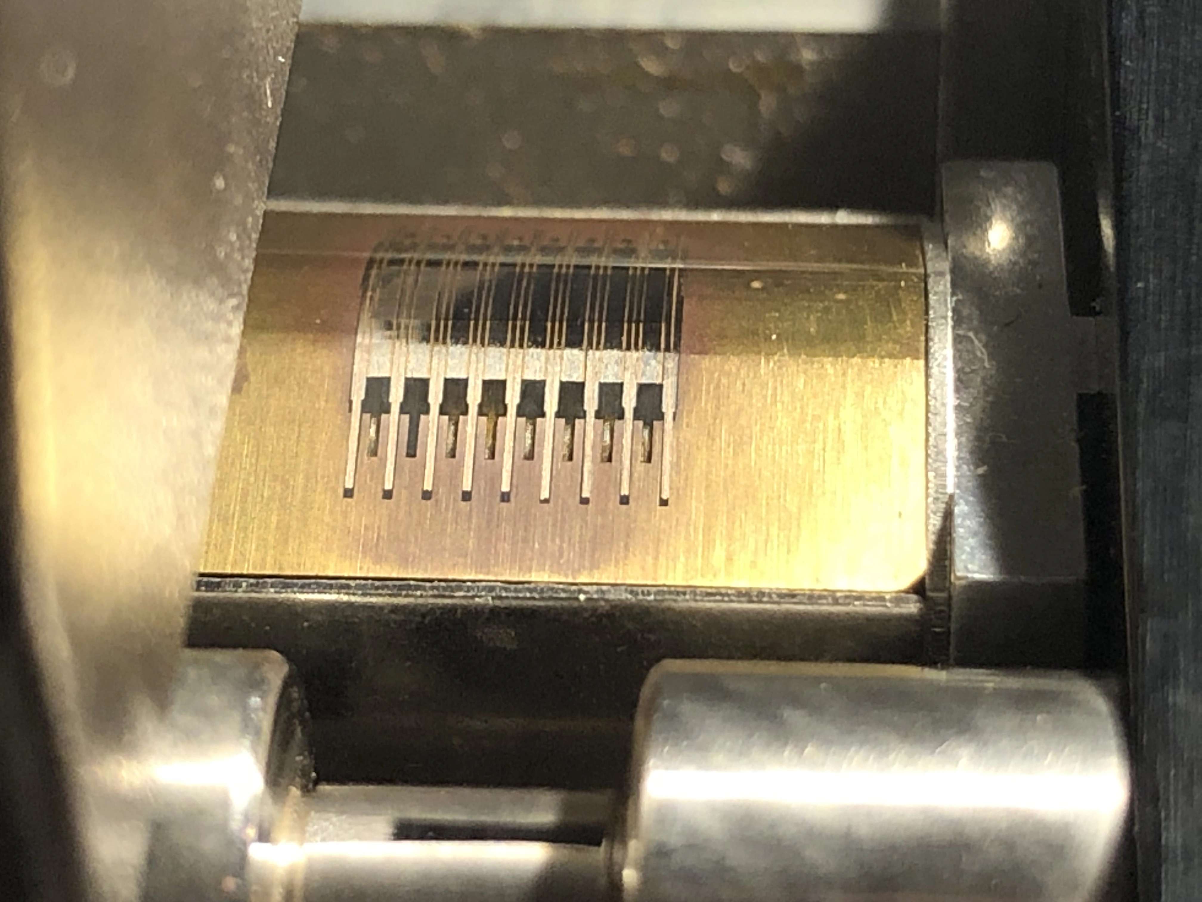

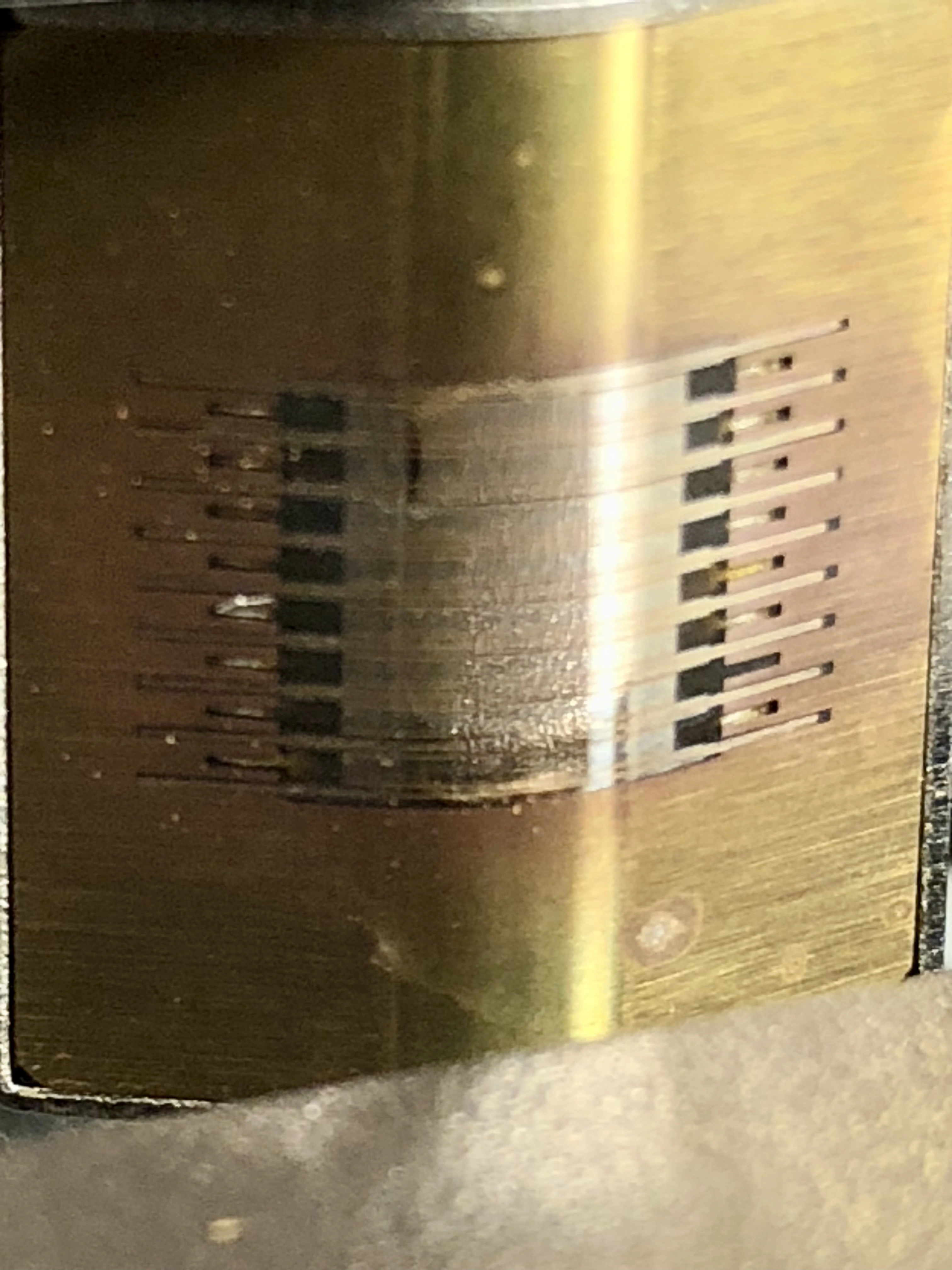

Here are a couple more pics of the head, really difficult to get and angle where it isn't reflecting the surrounding housing and light source but I think these at least offer some perspective
Thanks for the additional pics. At least by the pictures the R/P head looks fine to me. And clean :) I do see a wear pattern, so there is the potential for that lifting or curling if the tape is skewed across the R/P head.
