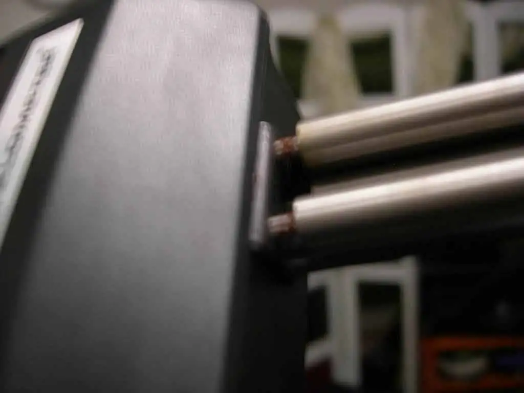

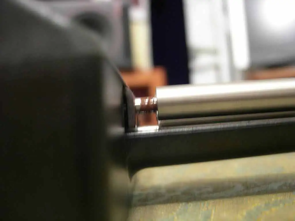

i'm using a piece of the rmg lpr35 (same that i'm using to record with) and the weight that came with the tentelometer (it says "1" on the side and theres a slip of paper that reads "3/32 Allen wrench, 1 oz. weight, 1 mil x 1" tape") there was paper over the prongs also that said "remove", so it almost seemed NOS, regardless the rust is pretty apparent and leads me to believe that it may be rusty inside, though the manual has scared me away from opening it in case i need to send it back to tentel sometime to be properly 'repaired'. despite the rust, it seems really smooth, if it would have calibrated within range I would have taken it for perfect working.
I have been holding the meter horizontal and going as the tape would go, have the oxide on the correct side etc, and just to try I've done it every which way, there is slight variation in the measurement.
with the 1" 1 mil tape that came with it it does calibrate to 1 oz, but at the most clockwise position.
here's pictures of rust:
I can't imagine how cleaning out the visible rust could help anything.

I'm not *sure* that is the proper model to use with the 388...you might want to email Tentel and ask.
Can anybody else weigh in on this?
Rolling probes are usually more needed and designed for VTR units...then again, pressure is pressure so it may be good enough to get the deck in the right range, if not bang on in spec.
Cheers! :)
I just cross-referenced the manual and Tentel's site on the T2-H20-1 and indeed that should work...spec'ed for "tape" up to 1".
LUNE I wish I could help further but without the unit in hand and a properly tesnioned deck with which to reference I don't know what to say. My Tentelometer is the T2-H20-ML with solid rather than rolling probes...same scale but works on 1/4" to 2" tape.
If it were me I'd probably be sending it back to Tentel for an assessment, but that's just me. It is a preceision reference instrument and if you can't trust it its worth little until you can, and I know I'm not brave enough to even open mine up.
Yep, the T-2-H20-1 is mentioned in my manual as well (which is the better part of why I bought the T-2-H20-1 model).
Thanks for considering my problem. I probably should/will send it to Tentel for evaluation/fixing, though I've got a few other things ahead in line that I'm going to have to be spending extra money on in the foreseeable future.
I have been recording with the machine as is and its been lovely. everyone I record on it or play stuff for is impressed, as am I. At some point I'm going to record some tracks at the same time on the 388 and the 38 (w/o DBX) and listen for differences.
...and of course I'll still be reading here for the next installments of the Story! and following suit with the alignments/bias adjustment at some point when resources permit...:)
