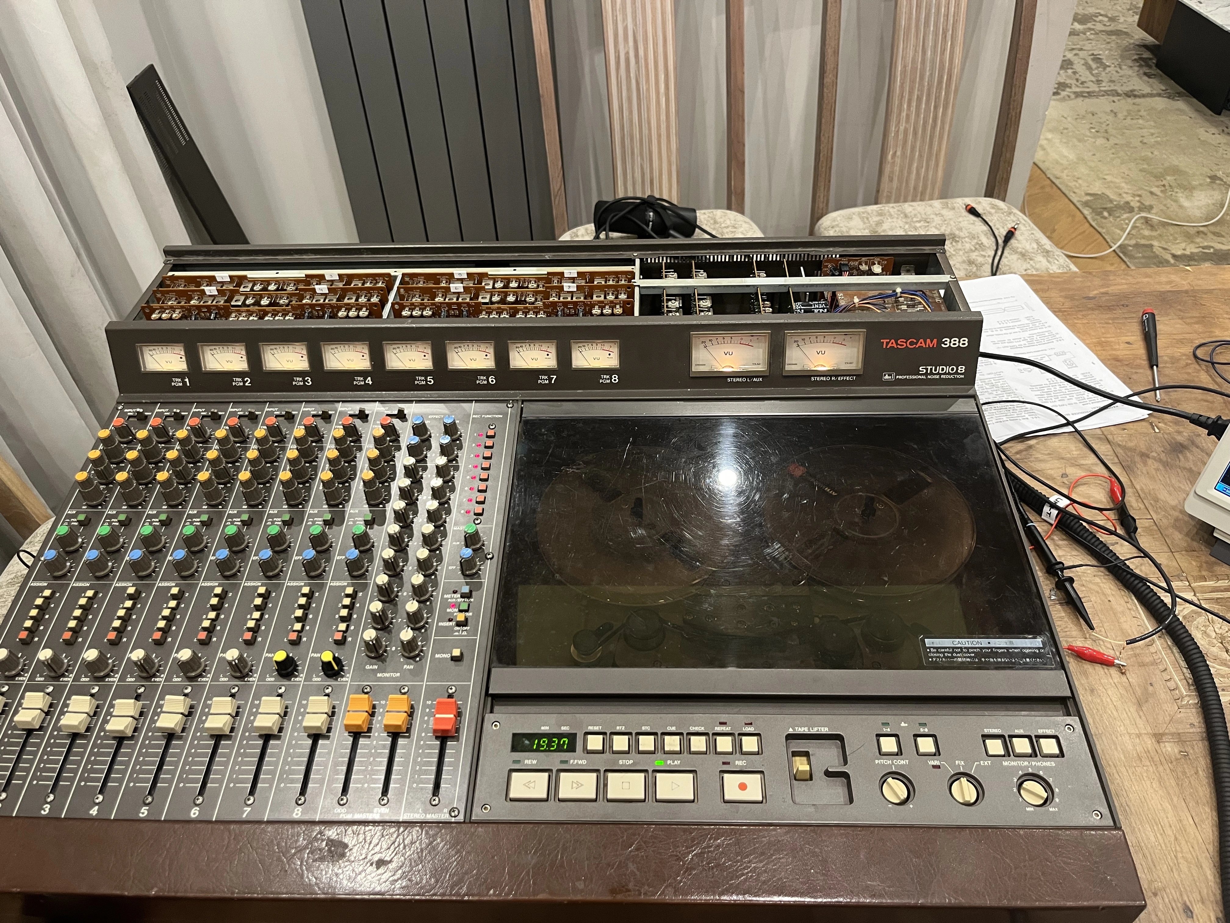

Hello Guys,
Hope this finds you all well,
I've recently decided to recap my Tascam 388, after the process, all mixer function are working fine but unfortunately the unit no longer erases or records to tape.
I checked all connections, re-soldered some sketchy points.
All PCB's working fine but the REC/PLAY and BIAS PCBs are completely bypassed or completely out of the circuit. " Thats just a guess" as I don't get any readings when measuring between the specified TP's.
I'd really appreciate any ideas or help from you guys.

Thanks sweetbeats, I'm still a noob when it comes to electric circuits just built a couple of microphones and preamps and thought I could fix it. Hopefully I'll figure something out. checked the BIAS OSC today using an Oscilloscope and its working 100KHZ. I opened one of the BIAS amps, Desoldered every part and measured all parts and all is working including the inductors, the transistors measured a little less hFe than on the datasheets. connected everything again using extended cables " Your Awesome Idea" and then tried measuring voltages. All seemed fine at the pins 1_-15v, 2_GND, 3_+15, 4_ OSC but then got stuck of what more to measure, as I don't have an idea yet of how BIAS Amp modules works, I also got back to the schematics and have all the voltages right going to the pins of the BIAS amp U101, the only points that had no reading where pin 4 and 5. So I'm still at point zero, but still trying. I'm afraid if its a logic problem, for example the recording signal is not going from the record button, just saying maybe, LEDS are lighting and all mixer functions working but still no Erase / Record :( . Didn't have the signal going to the L/R master swapped U104 as you said in one of your replies and BOOM it worked. Right now trying to find a replacement board or part, but the internet market is still empty :)

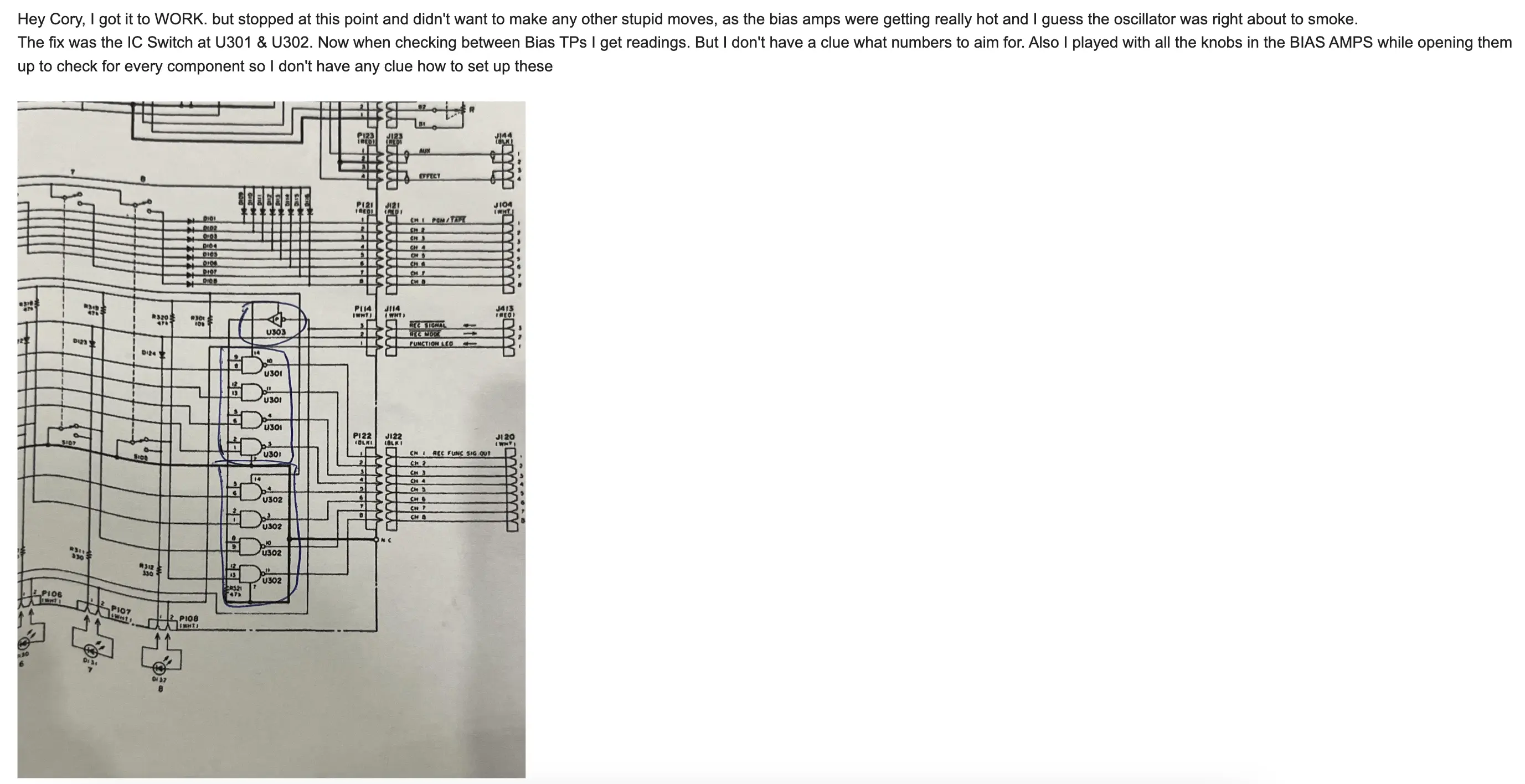

All of the switching that engages the bias amps for record or erase comes from the rec/play amp cards. If the problem is across all tracks there are two different control signals, one for record and one for erase that tell the bias amps what to do, and if none of that works I would start be looking at the source of those control signals and those connections. If it is all tracks but 1 & 6 try swapping rec/play amp cards to see if the problem follows the card swap. That will confirm your issue is rec/play amp card related.

Actually I got good news, I got all channels erasing and recording and every channel is working perfectly. Waiting on a tentelometer and MRL 4 freq tape to calibrate properly. The only thing I calibrated with the bias and bias trap.
The culprit was in the IC chip in the monitor board, for some reason it was sending a record off or stop signal, changed this all worked but channel 4 and 6. Channel 6 was a bad transistor in the bias board 1318 if I remember correctly, swapped this and channel 6 worked, channel 4 was in the buss B board it wasnt sending the signal for the tape & PGM outs nor the vu meters.
Changed and IC chip here and it worked. I got lucky I guess :) , but this thing was mind boggling, I’m an architect & music composer, and have very very little background in electronics, right now I think I can kind of find my way around schematics :), I kept drawing maps and traces to know what is going from where to where. Anyways I’m so happy I got it to work and thank you guys so much for all the help.
And please feel free to ask me anything, I’m not an expert but been drowned in these drawings for the last couple of weeks, so maybe I know a thing or two.
