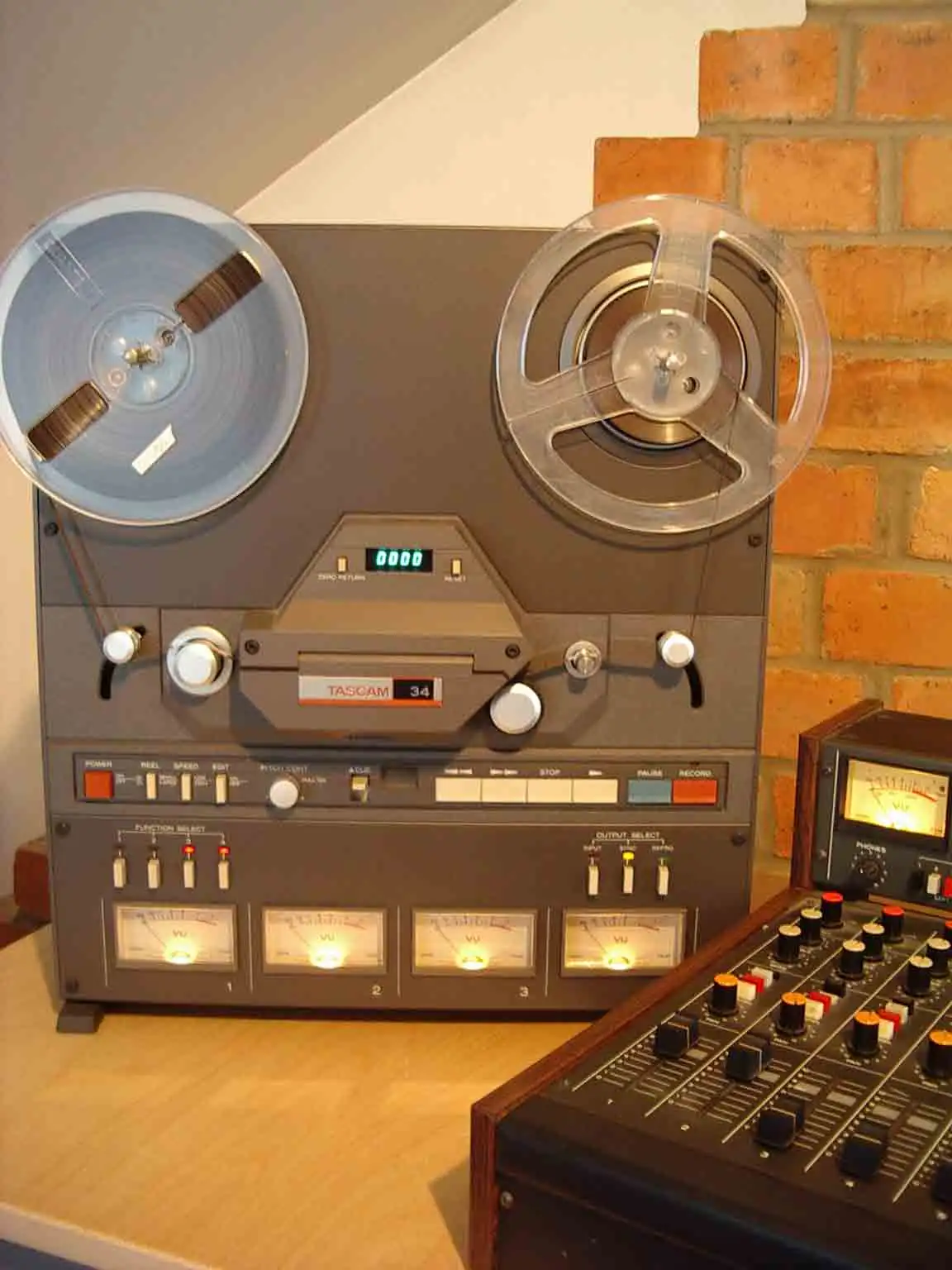

Hello again everybody. Out of the blue, 2 posts in quick succession. Anyway, I have recently acquired a Tascam 34, and am now in the process of hunting down an appropriate mixer to pair with it and start having some fun. I read somewhere that the older Tascam M-30 was a good match, but the only one I've been able to locate is in the US, and I dont fancy shipping it across to the UK. Would any later mixers be suitable? What features should I be looking out for? I have noticed a Tascam M-1516, which I believe to be '4-buss'. Would this lend it to be suitable for 4 track recording? OR, is there something more fundamental to consider, like the number of tape ins/outs on the mixer? In the M-1516's case it appears to be 8 ins. :confused: Ohh dear I'm so confused. Can anyone help?
Just for fun I've included a pic of the 34, and the accompanying 2A mixer that I bought along with it. Hmm on second thoughts, would the 2A mixer do for recording?

Hello! Nice pic!!
The M-30 is the most basic matched mixer to the 34.
Next would be the M-35.
Following that, would be the M-308/312/320, including the "B" models.
The M-1516 is 16-Input/8-Buss architecture, to the best of my knowledge.
A really classy mixer would be the M-512 & M-520, both 8-Buss.
The M-50 would be the 12-Input/8-Buss mixer that's the predecessor to the M-512.
Any one of these mixers would do a fine job. ;)
