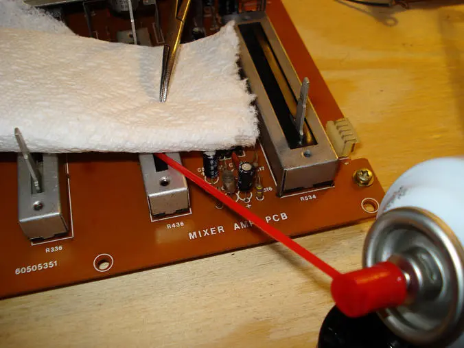

What's the best way to clean mixer channel and cue pots? I bought electrical contact spray cleaner from radio shack. It seems to work, but it's kinda greasy and leaves a residue. Although the cleaner comes with a spray straw, it still seems to get all over the place. Then you have to wipe this up with q-tips and some of the places on the board are hard to get into ..:confused: Many Thanks,
A
Aaron,
the RShack cleaner works really well, but, yes, it has a "problem", well sort of. Somehow the pressure is somewhat really really high. I have no clue what's the deal there, but it sort of does not feel "right", and it is really hard if possible at all to "regulate" the spray amount by pressing hadrer or easier, it's like "Non" or "All the way" with nothing in between :mad:, and it shoots like crazy.
Well, what you gonna do?
The way I did it: use the straw, aim it (see attached shot) and use a piece of cloth or napkin or something like that to cover above and maybe around to reduce the mess.
here's a photo I have, that I've made when was cleaning teac-144 pots and sliders:
