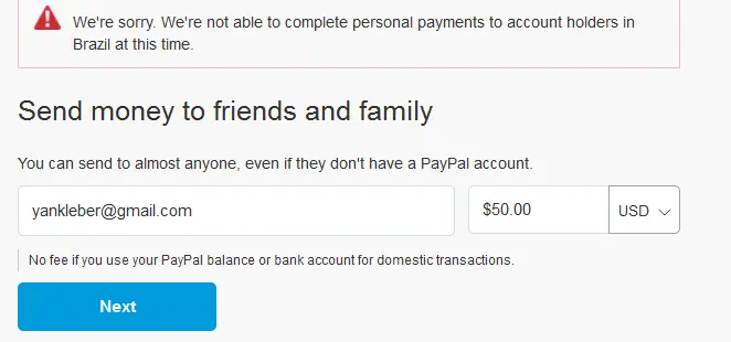

What's that email address for your PayPal?
Hey Jimmy, it is yankleber@gmail.com.
Aw Shit! :(
Well I tried...
No worries, Jimmy... your cool intention is what really means to me!
Normally I don't have any problem on getting cash through PayPal, but every new day is a new experience in this crazy computer world! LoL!
:facepalm:
