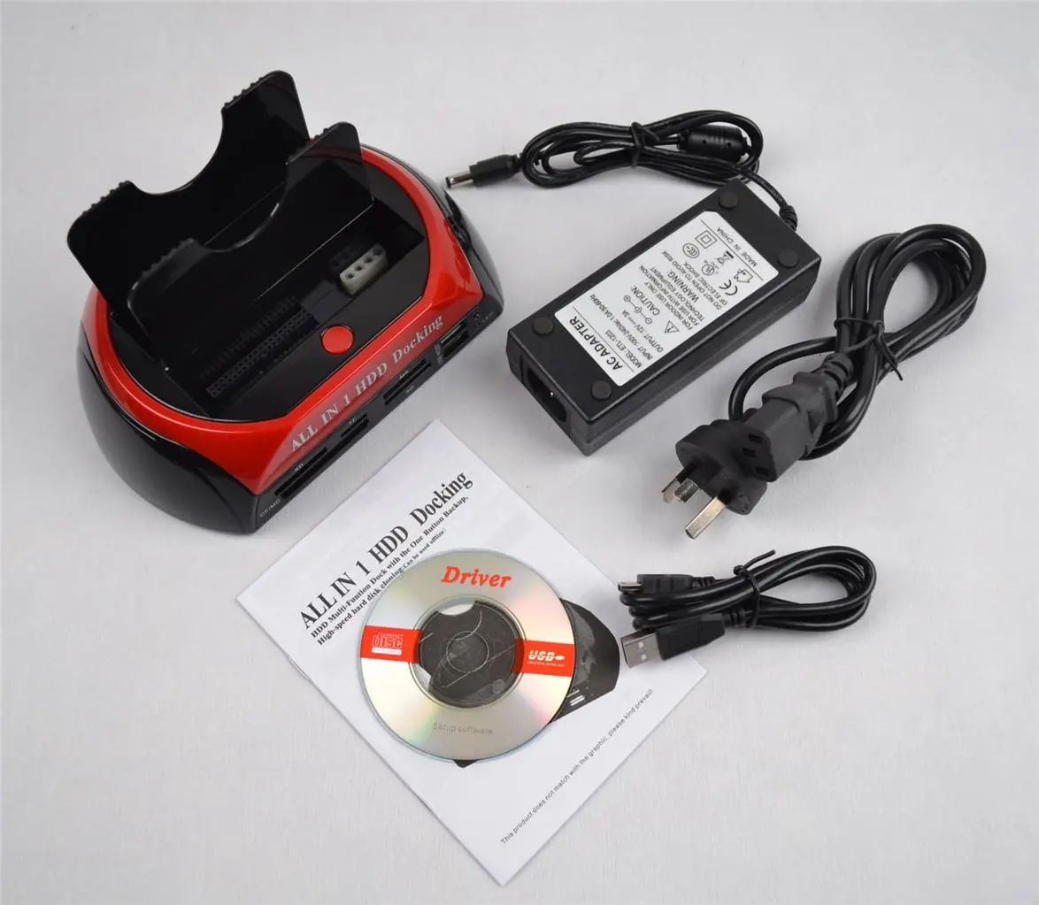

I have one of these in the studio for accessing various hard drives for files, very useful.
