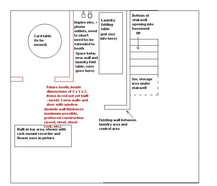

Chris, pix are probably enough but I need more details on the floor plan - I've done a rough sketch in Paint that's not right but shows the kind of detail I need - it doesn't need to be exact scale, just close. Adding text explanations with arrows, etc, helps a lot. Also info like whether you can/will build walls OVER existing tile or remove tile where the wall goes, don't be afraid to put more info than necessary, it's easier to filter out stuff I don't need than to try and imagine things I DO need to know.
Paint isn't the best by far, but if you play with it a bit, zooming in to draw smaller details, using color for separation of things, etc, makes it easier to explain things... Steve
