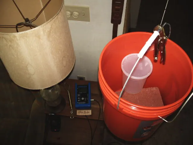

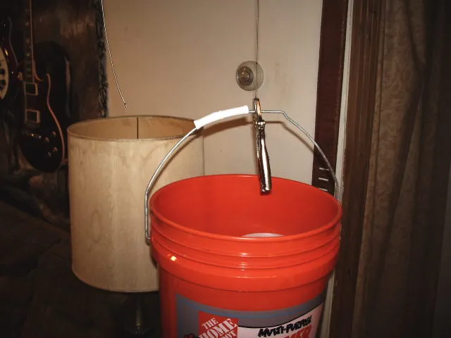

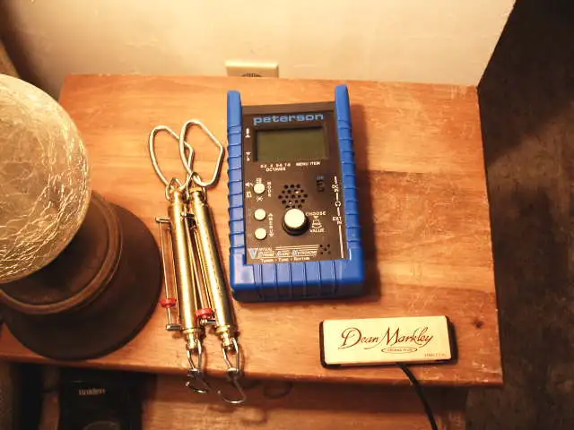

I started my experiment, I took a brand new GHS Boomer .052 and the same string from my SG that I put on in March. There is only 2 months of occasional use on it, I hadnt played it from May until present. I was rebuilding my studio. So I am not sure if this string would be called old. I was going to try this with a 13 month old acoustic string but I forgot I had just changed those. So this is the oldest set of strings I have. I took both strings and hung them from a beam. I tested the older string first, at exactly 26 inches I clamped a bucket with 2 bricks in it, I weighed the bucket, about 10 LBs. I then added water until I got a perfect "A" pitch. I used an acoustic pickup connected to my Peterson. I then clamped the same bucket to the new string and checked the pitch, exactly the same. It was an interesting experiment, I have egg on my face. Although I am determined to try this again with a very old string. I really feel though that old strings seem tighter and harder to play. What I love about changing strings is not only the great clear sound but the "apparent" flexibility.

Hey VP ..... take a pic of your experiment ..... I'd like to see how you hooked the p/u

I will take pictures soon, I am charging my camera. So If I let this new string hang here indefinately, I would assume it would stretch, getting smaller in diameter. A smaller diameter string with the same tension should be sharper. Well the string would also get longer, so a longer string with the same tension should be flat. Ureka! They cancel!? The pitch should stay the same. It has been awkward working here today with this hanging here, customers dont know what to think. I guess that is good because the less they know the better it is for business.

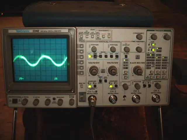

Here are some pictures of the experiment.
