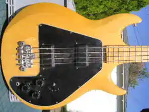

Here's a sample of the placement that I'm thinking about (not mine - just a sample that I saw on CL):
Would that seem to bring the bass more vertical than if it were right on the end of the bout, parallel to the neck?
This bass looks like a real neck-diver - my bass's upper bout isn't far off the 12th fret location, and doesn't dive as badly as my SG-style bass - I just like to play it more vertically...
If I understand what you are asking, no, it will make it worse. The farther out on the bout you attach the strap, the less neck heavy the bass will be.
