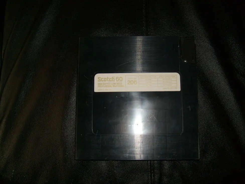

Excellent! this lot of tape is supposedly from 1976-77, I'll be grabbing it all today. Here is a picture of the one box I snagged and brought home already:
You lucky dog! :mad: :)
I love that stuff. Those are just like the ones I have.
Turns out most of this was in the plastic boxes (will get a picture up later) and already recorded... but a bulk eraser will fix that, and all the tap was climate controlled since bought - nearly 30 reels!

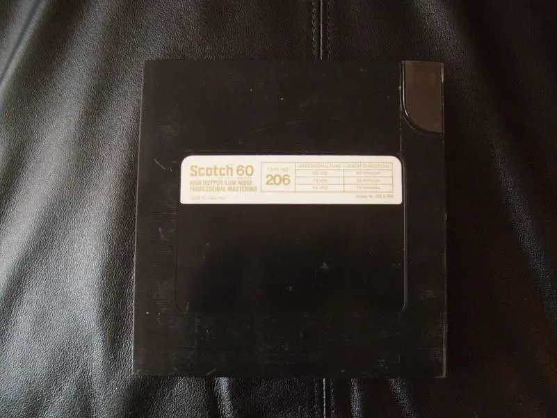

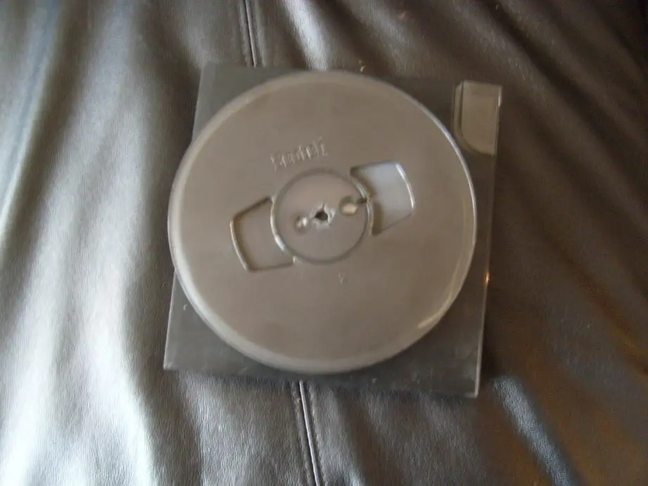

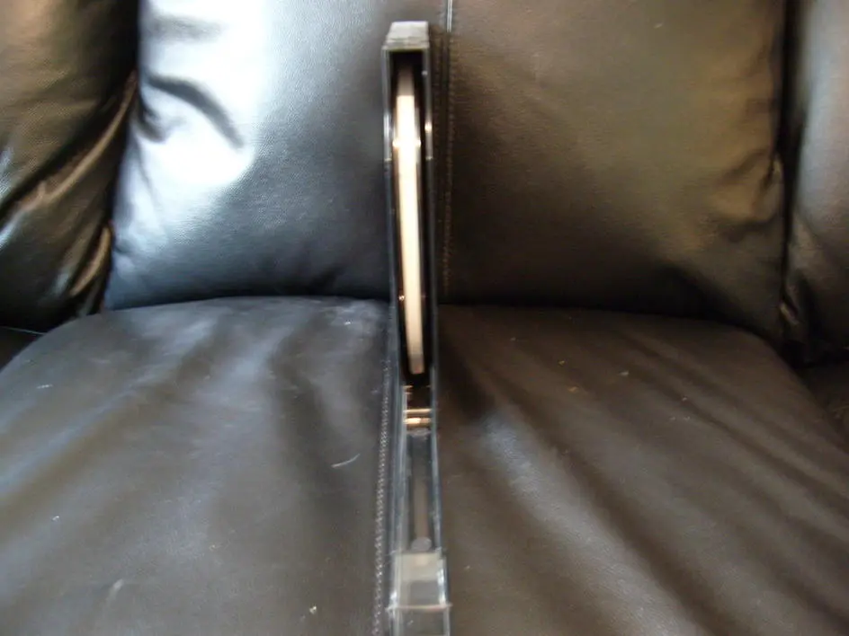

The plastic box stuff is Scotch 206, example reel here:
