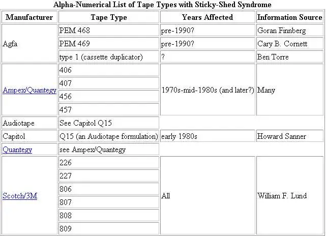

_DK said:
I'm still curious about AGFA PEM 468. A lot of people had bad experience with it. Like here: http://palimpsest.stanford.edu/byform/mailing-lists/arsclist/2006/03/msg00279.html
I'm curious, too. I can only vouch for BASF/EMTEC 468. That's mainly what I use on the M-79 1/2" 4-track. It's a superb tape, especially for my (not necessarily "loud") type of recording, where the consistent noise floor is appreciated. I will also definitely try out the 206 and 207 reels, now that I know there is some hope they will not be sticky.

ofajen said:
What about Scotch 250? I seem to remember that it has sticky problems, too.
Don't know about that but the above list may not be complete? :confused:

Yep, sticky shed info is in bits and pieces all over the web. ;)
The link from Daniel is a good one.
However, I have not yet seen a complete list all in one place. And even though I've tried to remedy that by gathering all the info on this forum I'm sure there are some I don't even know about.
Anyway, 250 is usually sticky and is a frequent guest star in my "List of Bad Tapes on eBay" thread.
It’s too bad because so many of these tapes were the bee’s knees when they came out. It pains me to see these beautiful new-old-stock specimens still sealed in pristine boxes because I know there’s a mad genie of sticky shed inside just waiting to come out.
