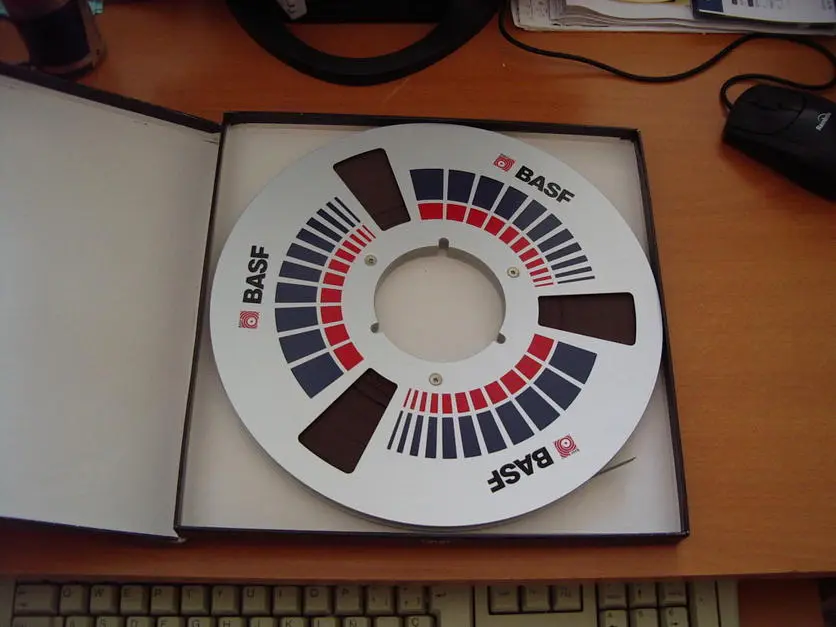

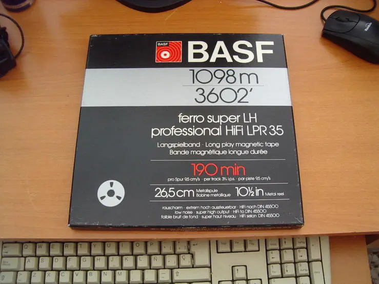

I wanted to ask is a BASF LPR-35 tape is OK for Teac 80-8 ?
I know that 911 or 468 could be better, but now I have a chance to grab one...
It's not seems to old and sticky ?
Thomas

BASF is fine but LPR-35 [1mil] is a bit too thin for what the 80-8 was originally setup [1.5mil]. Unless you readjust tension on your recorder, it might stretch the tape or worse brake it. You should go through an alignment procedure anyway, for a recorder of this age but I'd personally stick to either BASF / EMTEC / RMGI 911 or QUANTEGY 456.
BTW, if the tape in question is in your photo, then I'd be wary 'cause it's not sealed or appear new and you really don't know what's on there.
