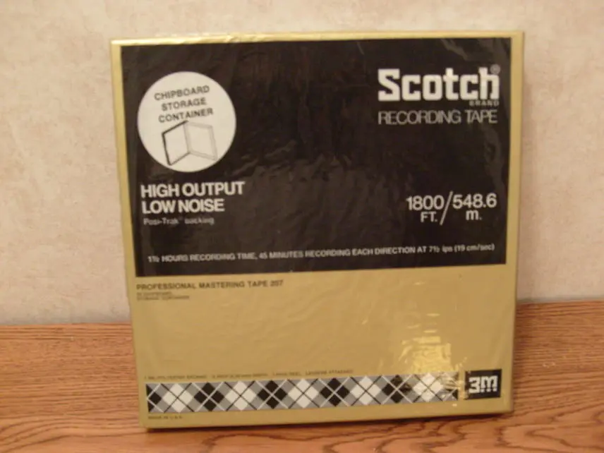

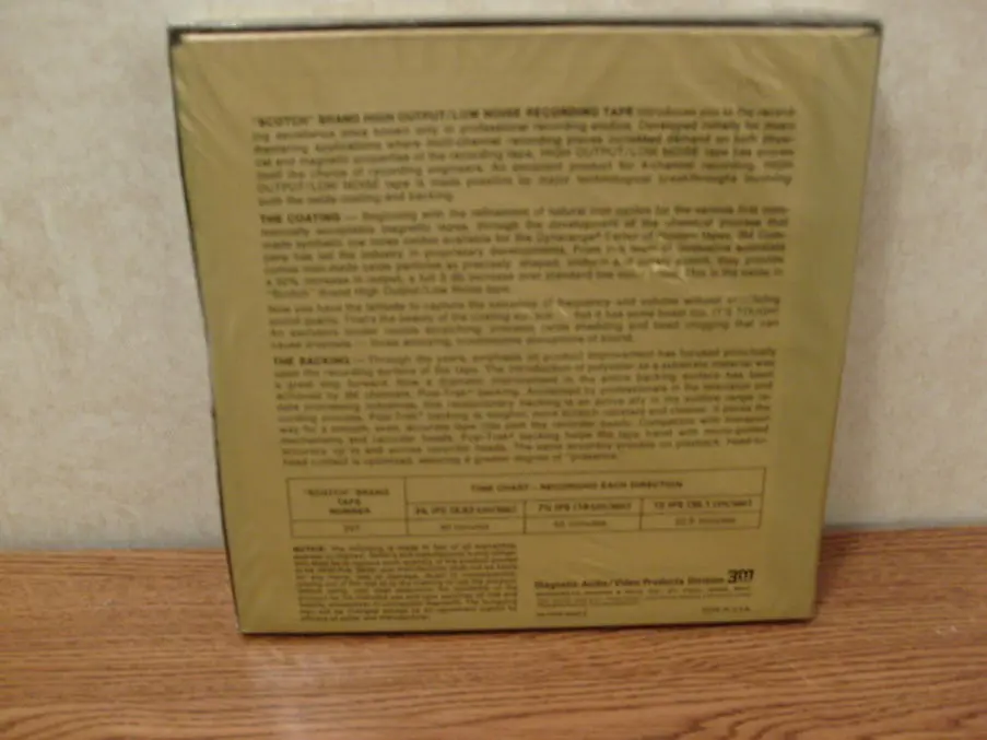

Ok, has anyone heard of any sticky-shed issues with Scotch 207? I have an opportunity to aquire a bunch of it new in shrink rap for a very good price. I have some older recorded tapes that are 207 and I haven't seen the sticky issue yet, but wanted to ask if anyone else has seen the issue.

I have the 1.5mil variant, the 206. All are fine. The 206 / 207 is not generally known to exhibit sticky shed, as it's a 1969 formulation [correct me on the date if I'm a bit off], which is before the manufacturers, in the USA, 'updated' their formulas, for the worse sadly....
206 / 207 is a safe bet.
BTW, Tim Beck uses and recommends this tape, which, I think, speaks for itself.. :)
Excellent! this lot of tape is supposedly from 1976-77, I'll be grabbing it all today. Here is a picture of the one box I snagged and brought home already:
