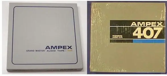

I have some Ampex 407, Redwood City address that someone gave me, but no date on the sticker :(.
It (the hold down sticker) is just a multicolored "407". I am assuming this is sticky-shed tape, but am hoping there is a possibility it is not.
One side of the tape is a dark, flat black color, and the other is an oxide red (if that makes any difference) - I can't remember which side is called the backer anymore.
Thanks for your help.
Cody
Lawrence KS
Not all AMPEX has sticky-shed, even with the Redwood City address. Late 1994 and later (practically speaking 1995 and later to be safe) are free of sticky-shed. One way to tell is the box style. Both of the two below are likely to have or eventually develop sticky-shed.
The newer box style is similar to the one on the right, but the logo is along the bottom like the current Quantegy
Those with the logo along the bottom 3rd of the box like Quantegy should be fine. The newer box style was adopted by AMPEX in 1994 and remained about the same, except for color and of course company name until Quantegy went belly up.
