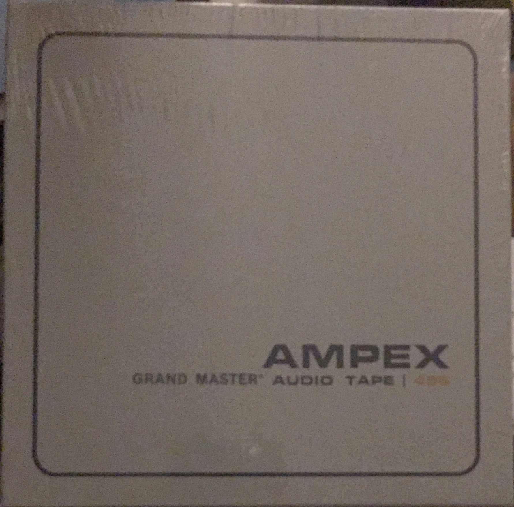

What does the box look like? If the Ampex logo is in the middle it’s bad.
I wouldn't call this logo "in the middle" but maybe you would?

That's an even older box. It's most likely sticky. I've had a lot of pre-1994 Ampex and it's all bad. In fact, I got a good deal on a Fostex A8, because the guy thought the transport was jacked, it was sticky tape. New 1/4" tape is available. You have several choices that will be close to 456. Check out splicit.com.
